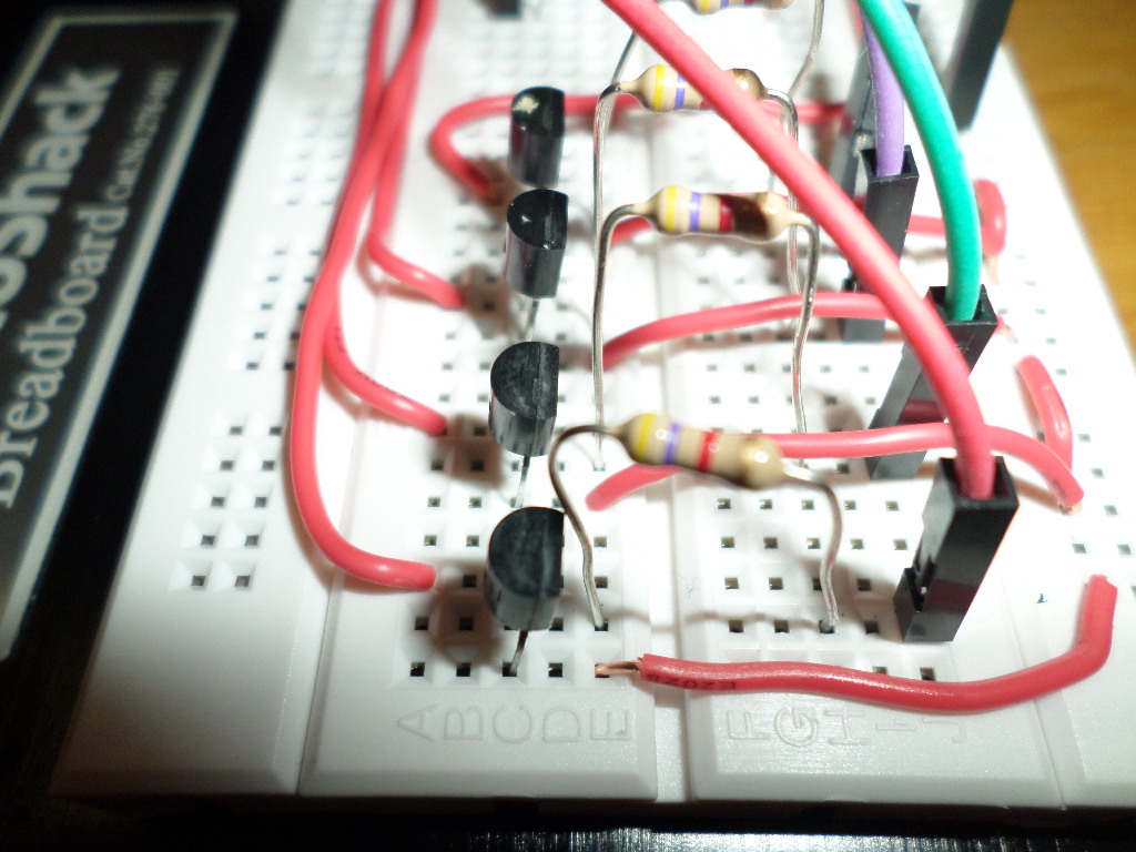

Finally got the program loaded. Now to go to work on the breadboard. bought a bigger breadboard. will try to lay it out so you can see how it is wired.

ran the program, no go. if I touch the pins with 5V the elements light up. I tried to attach picture but was told there to big. max 1 meg.
the picture is 3.5 megs. how do I make it smaller? wait I got it. pic coming
Nice and neat.
Might be nice to use different coloured wires to make things easier to follow.
Can you confirm the color on on the 470 resistors?
What is written on the transistors?
See image:

I assume there were no errors when you uploaded the sketch to the Arduino.
Are you using Multiplex7SegExample4Counter.ino ?
Please confirm the Yellow wire (GND) is indeed connected to ground.
OOPS is my face red. The yellow wire was wrong. PROBLEM. Only D segment is flashing on the last digit and solid on the other digits. Sometimes blinking on and off.
