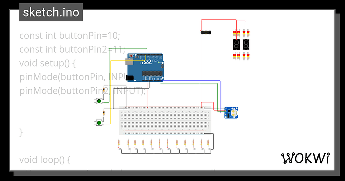

My project will work like this; According to the time information received from the RTC module, the LED showing the current time will turn on. Minute information will be displayed on 2 7-segment displays.
This is the draft I prepared for this project based on the valuable information I received from you.
Do you think it is a correct draft?
All you did was draw a picture. Sketch is blank.
Hard to tell; the wiring diagram is even more difficult to read than usual due to the spaghetti wiring being all of the same color. I'd recommend starting with an actual schematic diagram first to get a review here.

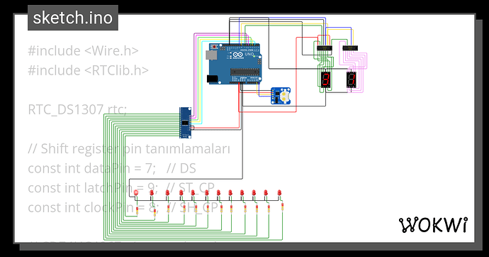

I have prepared a project draft like this. Can we talk about it? For example; Is my system setup logic correct? If there are any errors, where are they and what should I do to fix them?
I don't think so.

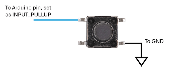

Wire a button like this:
Two connections, no resistors.
I'd place some pullups on the I2C lines, just to make sure/hedge against long wires/noise. Use something like 3k3.

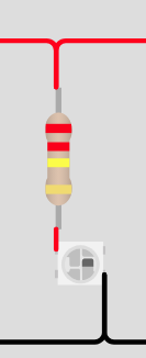

These look like WS2812 addressable LEDs. Is that correct?
If so, they won't work this way. Or did you mean to select a regular, passive LED instead? Note that your simulation won't work the way it is now.
I did not verify the shift register + segment displays. The HC595's do seem to wired in parallel; that's probably not what you want. How will your code differentiate between the two of them? The way you've wired this, they will simple mirror each other's behavior.
Moreover - it's a simulation. You can try things out; no need to ask if it's OK. The simulation won't mind if you fry a virtual Arduino; it'll come back to life at the press of a button. Why not break it down to a single button and a single LED, make the code for that (using the simulator) and solve problems as you encounter them? Once you've gotten the button + LED to work, add another part. And then another, etc.
