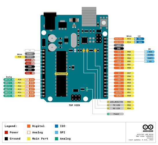

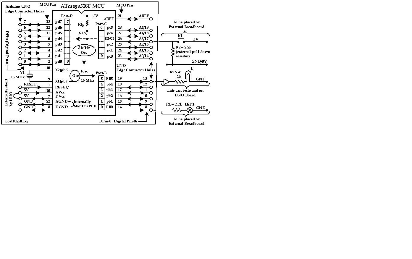

For a beginner, how good it is to ask ChatGPT to provide for a code to set the direction of DPin-8 as output? Does OP know what is DPin-8 and what is its purpose.
That's why OP has wanted to grasp the basics -- the following diagram (Fig-1) may help him.
Figure-1:
Correction Note: AGND and DGND are internally short in the chip/MCU.
Why confuse the issue? A good discussion of what this excellent Arduino reference image is telling the beginner would be more enlightening, in my view. I deliberately embedded, rather than linking, for image comparison. Scroll up, scroll down, zoom in.
Figures of #18 and #17 together may do better for OP.
