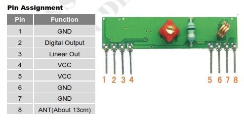

After testing it, you can improve your robot controling it using RF. With two arduinos and an Rf link kit 433 mhz you can have a very cheep set up
Here you have a complete tutorial controlrobotics.rodrigomompo.com
roter45: Here you have a complete tutorial controlrobotics.rodrigomompo.com
Nice site
i have 1 or 2 of this rf kit,but with more pins. Is it compatible?
yes
My robot use this model too.
Just connect digital output to the arduino and linear output without any wire.

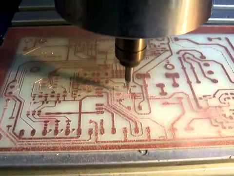

thanks for the code, but i think i not explain what i'm doing with the joystick thing. http://www.youtube.com/watch?v=PLHYmyXcQWY my robot is much like this one in the video , however i want only to drill the PCB.I want to control it manually too,this is the joystick service. does your code work for this purpose?
In this case, duplicate the code but changing the variables.
If you use the same variables (Just copy and paste) it won't work.
In this case, duplicated the code but changing the variables.
i duplicated the code, changed the variables and it working now. But one motor is not working properly, its not going backward,i think the problem is on the driver output. I'll make some tests and when my robot is working, i will post a video. Thanks for the help.
