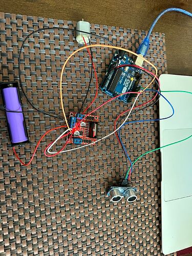

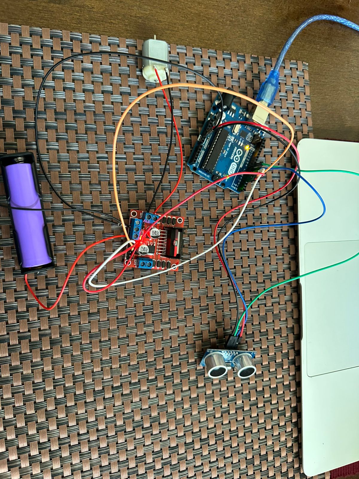

My motor auto turns on when connected to the battery power without reading the sensor. Can anyone tell me what could be the reason and help me with this please? Thank you.
Hi, could you possibly post a wiring-diagram, a picture and the code of your project.
Welcome to the Forum! Read the forum guidelines to see how to properly ask a question and some good information on making a good post. You will get faster and better help if you post all your code as requested by the forum guidelines.
Photos that clearly show your wiring can also be very helpful.

This is the diagram I tried.

On your wiring diagram, you have +12V going to VCC on your driver and from there going to 5V on your UNO - Yikes! Is that the Vin pin on the UNO or the actual 5V pin. Connecting 12V to the 5V pin can fry our board .
It's helpful if you describe what you expect or want this project to do.
A list of components followed by what goes wrong doesn't help anyone get a feel for the end result.

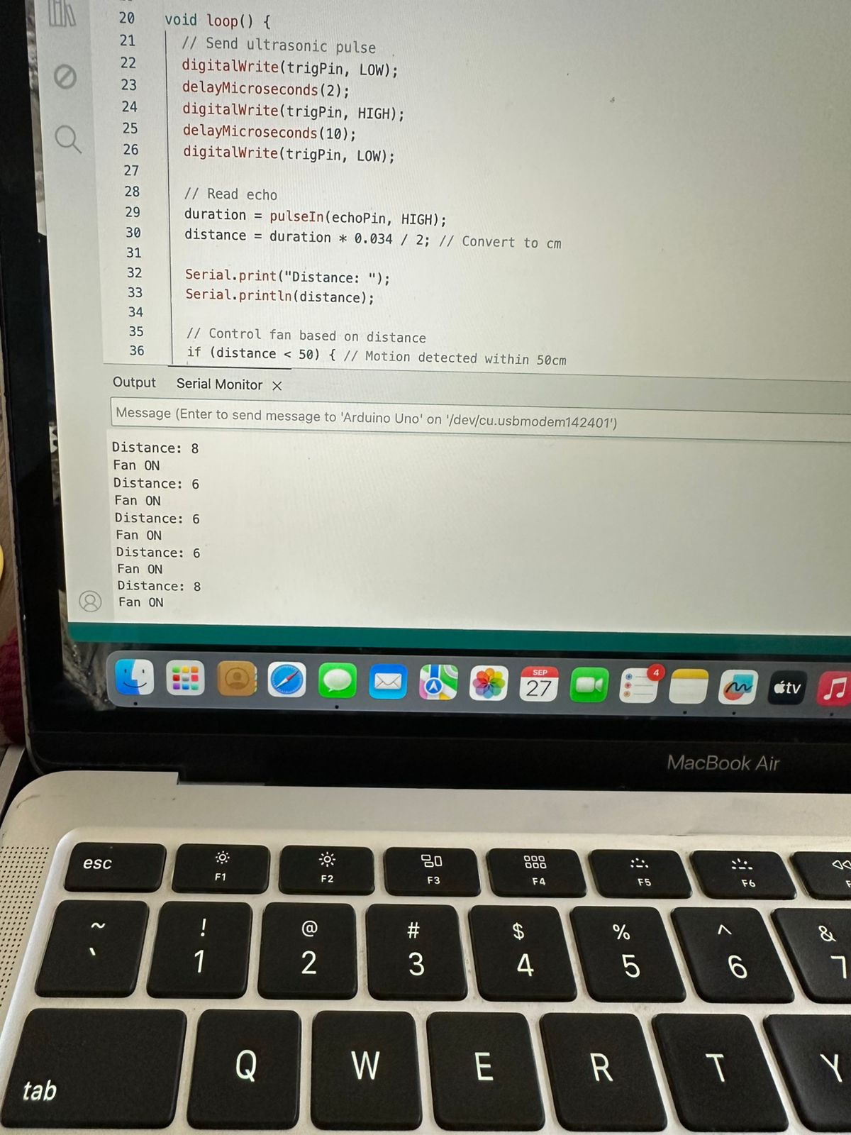

the serial monitor says "Distance: 0" all the readings
what I expect the project to do= I expect it to turn on when the distance is below the limit to turn on
example= Limit is 60 and the current distance is 80, so I don't expect it to turn on
Limit is 100 and distance is 80, so I expect it to switch on
but sometimes then fan just run because of the external power supply, when the distance reading is 0 and once I tested the distance reading it went crazy over 1000 and the fan was just running, even though there is no accurate reading or no reading at all.
In that case I would concentrate on getting the fan running over a range of values say 0 to 10 and do the distance stuff later.
Strip the code out of your sketch that deals with the distance and leave just the motor speed code.
Save the original code and save the new cut down version as a new sketch.

Since your code will only turn on the fan if distance is greater than 0 or less than or equal to motionThreshold it is doing what it should - not turn on since distance is not greater than 0.
I would focus on getting your sensor working all by itself. When that is done, then proceed to incorporate turning on the fan.
Does the fan turn on properly if you just hardcode distance to an acceptable value (such as 10)?
No the fan doesn't work according to the ultrasonic sensor distance, it just works when the external power supply is connected to the dc motor. I used it because the Arduino board can't control the motor alone.

Now ultra sonic sensor and the code is working fine. I have attached few images of my setup here.
Eventhough it says "Fan ON". Motor is not working. Can anyone help me with this?
I am glad to hear that the sensor is working but as is often the case, your pictures of the project provide little or no information as to how the components are connected and powered and posting a picture of part of your code is a waste of time
Draw out the circuit using pencil and paper showing the components of your project, the pins used, their labels if they have any, and how they are interconnected.
