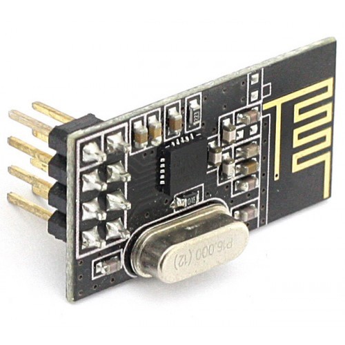

I am using normal NRF24L01 in my project. it is used as one way transmission. now i need to increase the range and thinking to use NRF 2.4Ghz NRF24L01+PA+LNA SMA Antenna. My question is that do i need to use this at both end or it is enough to replace only one used as transmitter?
You have not told us what range you want to achieve or the environment in which the nRF24s will be working - outside in a large field, or inside a building, for example, and what is the building constructed from?
I have not tried the high power units. I believe you will get some improvement with a single high-power unit.

i have to use it from 2nd floor terrace to ground floor in room around 25mtr. transmitter is at terrace. due to wlls it is not working properly. currently i am using this device
Thinking to buy this:
Thinking to buy this.. http://www.ebay.in/itm/NRF-2-4Ghz-NRF24L01-PA-LNA-SMA-Antenna-Wireless-Transceiver-Module-for-Arduino-/291939657896?hash=item43f8f5a8a8:g:XlIAAOSwnHZYchxW

I don't need too much range, but i have to communicate from 2nd floor terrace to ground floor in room, it works good in open space. but here i am sending data from over head water tank to ground floor room. and it not working properly, it receive data some time and some time not.
