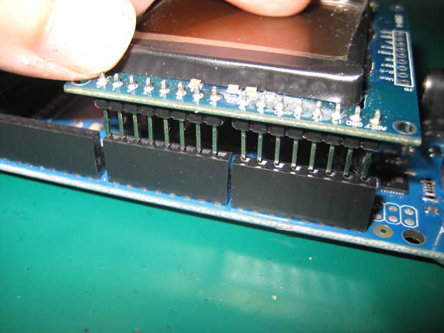

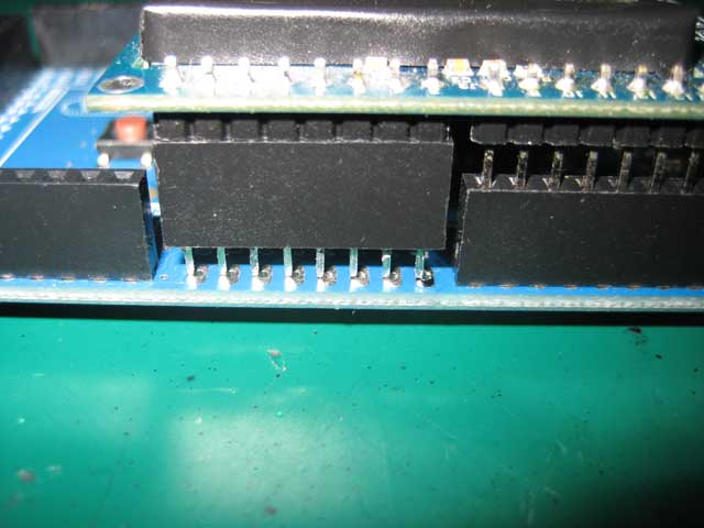

I'm afraid the build quality of my mega2560 isn't ideal too...
While I'm happy enough with the layout, it'll be fine for my purposes, and 99% of the target audience, what has got me are the headers, I get the impression they were soldered by hand without a jig.
I should imagine there was a deadline for the unveiling, and production may have been hurried. But something as simple as misaligned headers would have be so easy to avoid. Now, the blame here as far as I'm concerned doesn't lie directly with the Arduino team, but with the people who manufactured the boards, it seems most likely they skipped some steps to speed up delivery time.
I wont be returning my board, as electrically it functions perfectly, and 5 minutes reworking the headers is a lot quicker than the turnaround on a return.
It's also worth noting, I wasn't planning on saying a word, but more info might help if theres any disagreements later ![]()

Also, the plot thickens...
There is no way those are going to line up, something is in the wrong place...
That shield lines up perfectly with both my Diecimila and Duemilanove, I haven't got the old mega, but I believe shields should be compatible regardless.
With some creative bending and soldering mine now lines up, but surely this isn't right.
The holes are pretty much mis-aligned. :o
Sounds like the monkeys messed up with the 'industry standard arduino pin spacing'.
The old mega was fine for header spacing.
