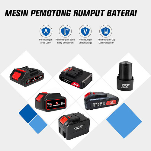

I want to make a tea harvester. It uses 4 24v/7500mAh separate batteries that will be combined into one unity.
Here is the battery im going to use (variant: YY 2V):
The battery will be used to run power towards the motor which runs the dynamo.

If you want to do it yourself you will have to count coulombs for any accuracy on Li type batteries.
