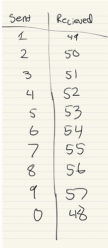

I am trying to send a String, one character at a time, from one Arduino to another. The String contained a list of numbers. It appears that for each char sent (one digit of the number), the other Arduino receives a value that is 48 greater than the number sent (See the image below).
I know I can just subtract 48 but I want to know why this is happening.

Because : ASCII
You are sending a character representing a digit, not the digit itself
But how come the correct character representing the digit is not being recieved?
What data type does Wire.read() return ?
Change the above to the following:
Serial.println((char)i2c_rcv);
