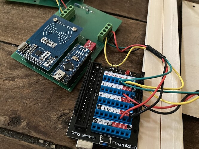

For my project, I would to connect 7 RFID readers (RC522) to a Arduino UNO. I know it's not easy to have more than 4 of these readers on the same SPI bus and managed by the same Arduino. So I decided to have one Arduino Nano per RC522 (probably a bit overkill but I wanted to stay modular) and then connect them via I2C to the Arduino Uno (controller).
I created one PCB per « block », containing :
  • 1 RC522 RFID reader
  • 1 Arduino Nano (target)
  • DIP switches to set the I2C address
  • 1 LED
  • Terminal blocks to connect the PCBs
A4, A5, 5V and Ground of all the Arduino are connected together. A button connected to the controller trigger the request to all the targets to get the last RFID UID scanned.

My issue: everything works well up to 6 blocks. When I add the 7th, the I2C signal seems to get jammed and quickly freezes the Arduino Uno. I tried to switch hardware, reduce wire length, add pull-up resistance (probably not correctly) etc. But the 7th block always causes the issue.
So I know that I2C is not easy to use on these kind of wire lengths. I read a lot about this and I’m a bit lost, sorry if I make you repeat yourself. I don’t really understand how to choose (and connect) a pull-up resistance in my case. I guess I could also have other type of wires? Or maybe there is something else that could help me?
Thank you in advance for your help :slight_smile:
I suggest you rethink how you are building this. Also consider reliability, is it important or is intermittent operation OK. From your pictures you have already exceeded the comfortable wire length for I2C, it was designed for chip to chip communication on the same PCB (Printed Circuit Board).
If it were me I would use CAN, it is reliable and good for several thousand feet of wire. It is multi master but you can have one master and the rest slaves, that is up to your software. Each unit can also be a master and slave again your software determines this.

some interesting comments seen in here that you might want to look at
I2C should only have one set of pull-ups
I see you have things daisy-chained so on the last board in the chain, put a 2.2K resistor pull-up on SCL and SDA

I know it is not the best way to look at your answers (thanks again!) but if there are things to try before changing my PCBs, as this project is time sensitive, I’m all ears ^^ I’ll try the pullup first (right now my issue is that I can’t reproduce the bug: everything works with 7 boards, but I know I’ve a reliability issue anyway…)
Hi there!
To give you an update:
When I wanted to test again, with an Arduino MEGA (which has pull-up resistors on SDA/SCL, maybe that was a factor) everything started working. I really tried a lot of configurations, I built the circuit in 4 copies, I tried to put various “interferences” but overall no more issue... including by switching back to a UNO :sweat_smile: So I'm a bit lost, I'm aware that the system must not be very robust with these cable lengths but for the moment it's difficult to debug.
