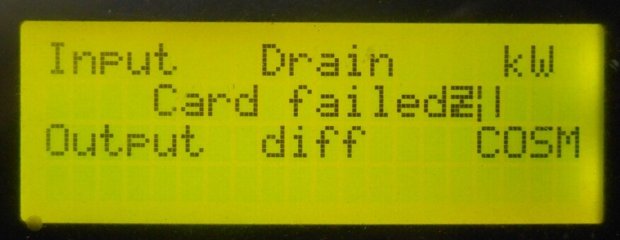

I have had untold grief from getting my 4x20 to work. It was fine a couple of years ago but, now that I have gone back to it, I guess I must have polluted my library list somehow.
The display has the "YWRobot Arduino LCM1602 IIC V1" board on the back.
The library is the fmalpartida, which I have never used before, and I have removed all the other I2C LCD libraries. The "hello world' example works fine. The grief starts with my own application as soon as it starts.
In the first two print commands, I get two mysterious characters printed immediately thereafter.
Preceding the command with a clear doesn't fix anything. If I add a couple of spaces, I don't print over them, they are simply moved along two spaces. This leads me to believe the characters are pinted after, or as part of, the print command.
The second print command does the same thing. The characters are the same.
The next section of lCD printing, being on lines 0,2, appears to be OK
This is the relevant code

Don't use println() as it adds the newline and carriage return characters at the end. (the two mysterious characters)
Most LCD font files don't go under printable characters (Dec 32), so those two come out as garbage.
Thank you, it really was that simple. God knows what they are doing there but it seems that you can get away with that sin when using a 5110. I have quite a few programmes to clean up. Every lcd.println is redundant.

No patch is ever required. Do not use println() on an alphanumeric LCD. It it meaningless. Simple as that.

The LCD controller uses the ASCII codes that you send it to point to an address in it's character memory.
The ASCII codes 0x20 and above (called the 'printable' codes), point to CGROM (Character Generator Read Only Memory) where the hard coded information needed to display each displayable character is located.
Some of the ASCII codes below 0x20 (called the 'control' codes point to CGRAM (Character Generator Random Access Memory) where the user generated 'custom character' information is located.
There is only enough RAM available for 8 custom characters and it is located at addresses 0x00 - 0x07. The next 8 addresses 0x08 - 0x0F are 'foldback' addresses which access the same 8 memory locations as addresses 0x00 - 0x07.
The extra characters sent by println() are 0x0D and 0x0A. These are foldback addresses corresponding to two of the custom characters, and since you probably haven't programmed them you get pseudo random 'mysterious characters' displayed on your LCD.

You appear to have some misunderstandings as to how things work.
The "print" library or "Print" class is a library that does basic text character output formatting.
The Print class works at an ASCII character level not a pixel level.
The Print class has nothing to do with fonts or pixels and in fact has nothing to do with LCDs as it is not device specific.
The Print class takes things like numbers and converts them ascii character codes for each digit.
The Print class hands all its formatted character output, character by character over to some other class to process.
In this case it gets sent to the LiquidCrystal_I2C class write() function which then does what it needs to do to send each character code to the LCD using the PCF8574 i/o expander port.
"Font files" as you are saying are not involved and do not exist at all when using a hd44780 display.
The character code to font pixel LCD display information is stored in an on board rom on the hd44780 lcd module.
As don said the module does have some ram (64 bytes) to allow you to override the built in font pixel map but only for 8 code points (really 16) since the 8 repeat. So character code points 0-7 are the same as 8-15
So as you say "Every dec value should have some kind of visible ascii character". The hd44780 LCD does have this capability.
It is just that the first 8 code points, which are the user defined code points, are not specified to be anything by default by the hd44780 spec. i.e. hd44780 compliant LCDs are not required to set those 8 character code points to some kind of default character glyphs on power up.
So if you use them without initializing them, you get garbage.

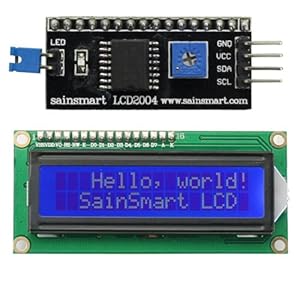

It requires understanding the i2c backpack hardware and how it interfaces to the LCD.
The backpack uses a PCF8574 i/o expander to drive the hd44780 pins.
It will require examining the actual LCD backpack PCB to figure out how the output port pins are wired up, specifically pins 4,5,6,7,9,10,11 and 12.
(this takes maybe 5 minutes, and may require an ohm meter)
And then reading the hd44780 spec to get a grasp on the how the control signals work, how commands and data are sent to the LCD, and then the initialization sequence needed. In this case how to reliably put the LCD into 4 bit mode.
Time for this may vary but if even if you are not very familiar with data-sheets an hour should be enough time to get a good grasp on how the part works and the signal pins.
To play at this level, then learning how to read datasheets and understanding how the hardware works is a must.
For this project, once how the PCF8574 is wired and hd44780 4 bit mode is understood, then there would be no need to look at an i2c LCD library as how the interface worked would be understood.
And then it would be obvious what to send over i2c to control the LCD, which would allow writing the low level s/w routines to send the bytes and then the higher level API functions that sit on top of that to send characters or commands to the LCD - which is what the i2c lcd libraries do.
But if I really need to know how the I2C bytes translates into lcd instructions I just hook up 7 of the 8 channels of my logic analizer on my lcd screen and see how it works. And after that has been done, than I would recommend to take a dive in those complicated librariers. This is 100x more easy than what you suggest.
One can learn more out of hardware exercises than from complicated libraries. It sure take way less time to use a logic analizer and write down your findings than to entirely comprehend 3-4 different libraries which might take god knows how many days if not weeks.
This is the wrong approach, particularly in this case where documentation is readily available. While hooking up probes and attempting to reverse engineer the interface can work for certain situations, it should be a mechanism of last resort since it does not really ever offer the ability to truly know and understand the interface.
And given your previous comments it seems that the even after this initial reverse engineering exercise, it is still not understood how to control the LCD for characters and commands.
Reverse engineering is also often much more time consuming than simply reading the documentation/specifications.
This methodology also cannot ever offer a complete picture of how the interface fully works, nor will it provide any information related to initialization or timing requirements/boundaries, all of which are in the hardware specifications.
Also, keep in mind that by looking at signals for a working system you are only examining what THAT particular system is doing.
It is a specific implementation that may or may not be following the specification and it may or may not be able to provide enough information to grasp the real full interface and its timing requirements.
That is why reverse engineering can be so difficult and often leads to less than optimum solutions.
In this case it is simply not needed, as you have direct access to the backpack to easily determine the design and its wiring and hd44780 specs are readily available for free from the internet.
Once the interfaces are understood, that knowledge could be used for other situations/projects.
It would directly transfer to know how to use a different i2c backpack that used the same PCF8574 but was wired differently, or even another interface like a shift register implementation.
