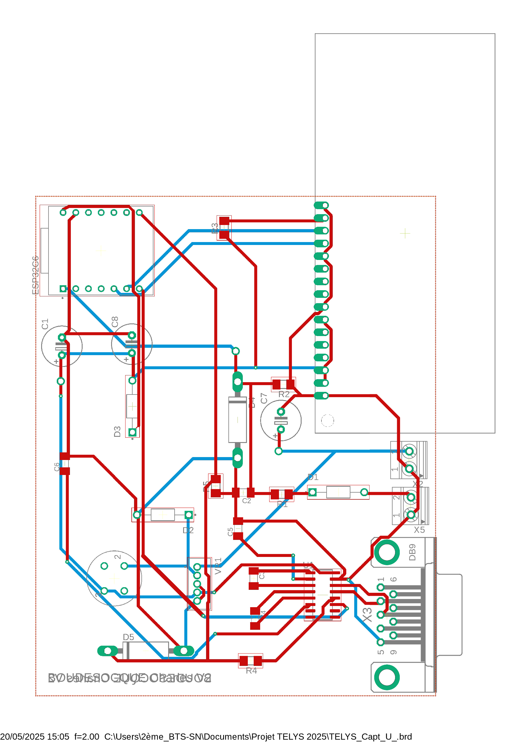

I am using a XIAO ESP32-C6 and the screen is powered externally with a generator. My schematic:
Every pin that needs voltage has 5V except the SCL and SDA pins that get 3.3V due to them coming out of the ESP32.
According to the MC21605C6W-SPTLYI-V2 datasheet (that you can find here), I would need pull-up resistors on SCL and SDA that I haven't put on, which would be frankly annoying since I would need to fabricate another PCB, and I don't really have the time to (project deadline is on the 10th of june)
I've tested if the LCD is connected using an I2C address scanner and i've found that it is connected at the 0x3D address.

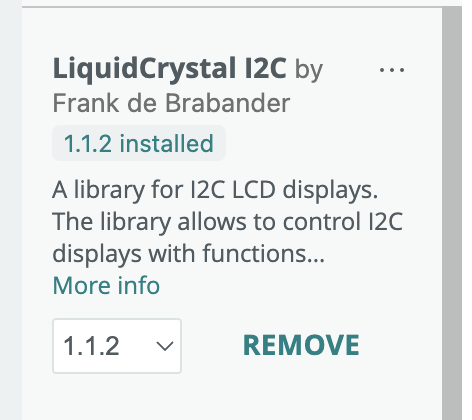

BTW, I always use the following library with no problems and NO pullups
I forgot to mention I also tried that library, to no avail...
I could try to add those pullup resistors but it isn't going to be pretty since i'd have to cut open some of the connections with a box cutter and solder a resistor on top, AND my Sda and SCL connections are on the underside of the PCB :smiling_face_with_tear: which is why I'm hoping to find some alternative to butchering it :joy: Here is my board schematic:
I think one of my main problems is that i can't seem to find a library that works with the controller of my LCD, which is a RW1063.

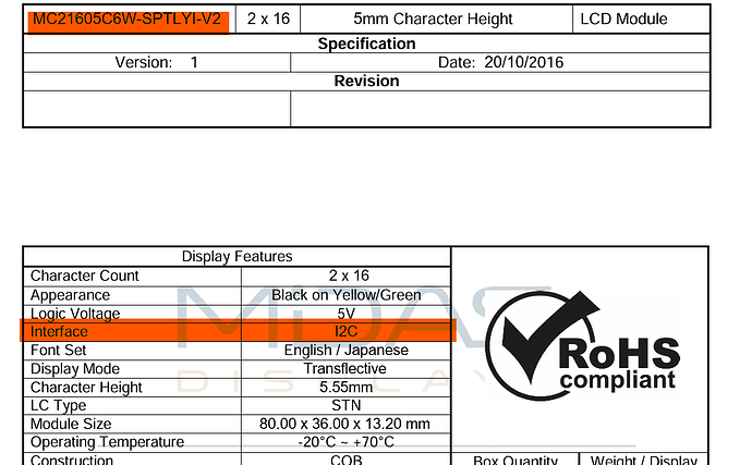

If you go to this website https://midasdisplays.com/shop/lcd/lcd-character/mc21605c6w-sptlyi-v2/ you can get the datasheet of the LCD by clicking on 'specification' where you can see the pinout of the LCD, there's 16 pins but a bunch of them are unused. There are a lot since this LCD can work in I2C but doesn't always do (from what I understand) , there's a CS pin to toggle it on or off, there's also 2 pins for the backlight, 2 pins for the slave addresses,
Here's a photo of the LCD as well
That is NOT an I2C board, it's SPI. I think you can buy the backpack board but not sure. The backpack board has a lot of components so it's not a simple change. Here is a Amazon.CA link to just the backpack, but for an extra $1 you can get 4 backpacks and 4 1602 LCD's. Try the usual suspects for better pricing.
https://amz.cx/3SDl
I do already use SPI in another part of my project, which uses the RX/TX pins of my ESP, Also the constructor website and the datasheet both state that it is I2C, and there's no I am a bit confused ? An SPI LCD would have a MISO/MOSI pin set which are not present here

That LCD device appears to be configurable for parallel, SPI and I2C.
The jumpers IF0 and IF1 control the mode.
In your photo, it appears that the jumpers JIF0 and JIF1 are set for I2C mode.
From looking at the datasheet the I2C communications protocol is using the same as protocol as the PCF2116/PCF2119x or the AIP30168 chipsets.
The hd44780 library includes support for that LCD protocol over I2C.
You will want use the hd44780_I2Clcd i/o class.
It isn't clear if the CSB pin is used when in I2C mode. I'm guessing it is not used in I2C mode and is only used in SPI mode.
