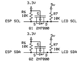

For an I2C LCD display to work, the I2C address and the I2C backpack to LCD pin mapping must be correct. If the library default settings for either or both are not correct the LCD will not work. You can try to figure out the right pin mapping and use an I2C scanner to find the address, but if you install and use the hd44780 library (mentioned by @floresta) that is done automatically by the library.
To use a 5V LCD with a 3.3V processor, power the LCD with 5V and use levels shifters on the I2C lines to shift the 5V LCD signals to 3.3V for the processor.

Today, I received the "level shifter," and I'm trying to connect it properly, but it doesn't work. I connected the ESP32 to the level shifter and then to the LCD, like this:
Is this the correct way to connect it?
This is the "Level Shifter":
https://www.amazon.es/dp/B095H64XSV?psc=1&ref=ppx_yo2ov_dt_b_product_details

I would say no but I can't really tell since the minimal schematic you posted does not accurately reflect that h/w that you have and, IMO/guess, is likely not how you have actually wired things up.
You have an ESP32 board hooked up to i2c backpack so we need to how you have actually wired up everything now that you have changed the wiring from what you posted earlier.
i.e. your schematic shows what voltage goes to the LCD but not what voltage is powering the backpack (PCF8574 i2c expander chip).
i2c backpacks like the one you are using have a VCC pin on the header.
That VCC pin runs power to the PCF8574 chip, the onboard pullups,
and powers the LCD.
In most cases, the LCD needs 5v to get proper contrast as most of the low cost LCDs are 5v parts.
If you need to run the LCD at 5v the easiest way to do that is run the backpack at 5v but that also means the i2c bus signals going to the backpack will be 5v.
And because the i2c backpack i2c signals are running at 5v and the esp32 runs its i2c signals at 3v, a level shifter is required to connect the 3v ESP32 i2c bus to work with the 5v i2c bus of the i2c backpack.
If you don't use a level shifter and directly connect the 3v ESP32 signals directly to a 5v i2c bus, you run the risk of frying the 3v ESP32 since you are connecting its 3v signals to 5v signals.
In terms of how to hook up a level shifter.
A level shifter can be used to connect two i2c busses of different voltages.
Typically this is used to connect a 3v bus to a 5v bus.
I have seen two types of low cost level shifters.
  1. onboard 3v regulator
  2. no onboard 3v regular
If you have type 1 level shifter, there is 5v pin and a 3v pin.
The 5v pin is an input that you connect to 5v and the level shifter creates the 3v on board using a regulator so the 3v signal is an output, not an input.
If connecting a 5v processor to a 3v devices, you can use the 3v pin to power your 3v devices.
If connecting a 3v processor to 5v devices, you leave the 3v pin disconnected.
If you have type 2 level shifter.
These have two voltage inputs. Often labeled as, LV/HV, A/B, L/H, or 1/2
Both voltage pins are inputs.
Connect one side to 5v for the 5v i2c signals, and connect the other side to 3v for the 3v signals.
From your link you appear to have type 2
