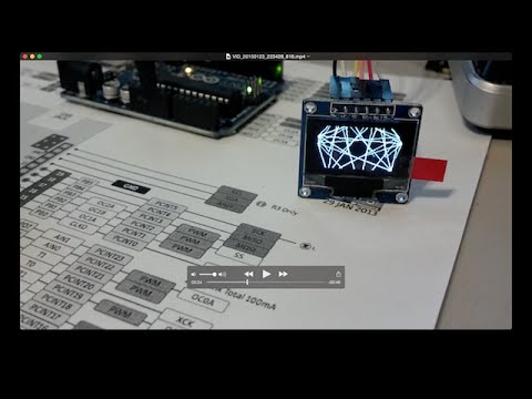

I'm wanting to run multiple SSD_1306 OLED displays using the Adafruit TCA9548A. The video below shows 4 screens running from an Arduino Due - seems to run the fastest of my boards.
Usually, the Teensy smashes everything else in terms of speed, but not in this case.
Is there any way to speed up the display re-draw? I'm expecting a new Teensy 3.6 shortly, but apart from getting the fastest board available, is there anything I'm doing in code that is slowing things down?
I realise I'm repeating a lot of calculation, but the code posted is the only way I can seem to get the system to work...
On a slightly different tack, bearing in mind I'd like to use many screens in an installation, I could use a PC or Mac to drive these things - but how? And would it make any difference, or is the bottleneck in the screen re-draw on the SSD 1306s?
Any advice would be gratefully received!

The bottleneck is the I2C, no matter how fast the possible goes the I2C only works at 100K bits per second. With other libraries you can get it to run faster but not very much faster. Speeds are 400K and 1.3M, although I have never managed to get anything going that fast, 800K is the fastest I have got but it depends on the device. Look at the I2CMaster library.
SPI is much faster than I2C (module does both), and the module has a CS (chip select) pin.
AFAIK no need for a muxer.
Leo..
Ah, I need to look into SPI - but AFAIK, there s no CS pin - just clk and data...?
The Adafruit module has a CS pin.
So the chip itself must have a CS line.
Probably not brought out to a pin.
Check the back of the module.
Leo..

I bought a load of these, hoping to have an array that acted as a kind of 'video wall', with one image stretched across many display - as in the video I posted earlier on...
So you reckon I will not be able to increase the speed of the animation much?
I did notice a big difference when I plugged it into a Due, previously it was running on a Chinese nano... : )
So if want fast drawing, I'd have to shell out for a more expensive SPI ready display? any recommendations in the sam kind of form factor?
Thanks!
timothy_cubed:
As Mike said earlier, you may be able to get them to work at 400KHz instead of the default 100KHz. Try putting "Wire.setClock(400000);" just after "Wire.begin();". If that works, and the speed increase is still not enough, then the next question you need the answer to is what's causing the slowness, updating the displays, or drawing the image? Do some timings in your code using the micros() function to find out.
If only a small part of the time is taken by updating the displays, then you need to look at making the rest of the sketch more efficient.
If it is the updating of the displays that is taking most of the time, then then you may need the SPI version of the display (which is what is shown in the youtube video you posted).
The Due is more suited to dealing with multiple displays, having more memory and a faster clock speed. You could look at other boards, such as Maple Mini, Teensy 3.x, ESP8266, all of which have similar capability to Due, are cheaper, smaller and and be used with the Arduino IDE and sketches.
