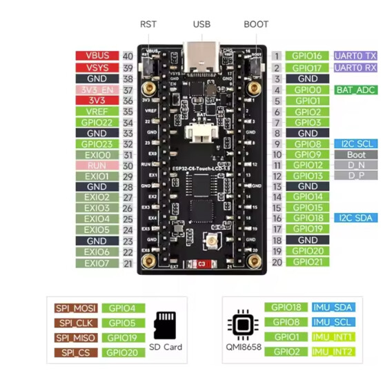

Trying to figure out how to connect an I2C device to ESP32-C6-LCD-1.47
Pinout charts I see online does not have sda/scl showing on the devboard pinout. (updated diagram below)
I'm trying to connect an AS5600 (angle encoder) - but all libraries I can find use the default SDA/SCL, seems to be GPIO 21/22 for ESP32-C6 in general - but which are those on the dev board?

I don't know if this is exactly the same board, but I found this picture:
Hope this helps

the board looks like this
There are multipurpose pins that can be used as I2C but those libraries that I could find seem to look for the default one which I don't know if attached to the board IO
this is the board https://www.waveshare.com/wiki/ESP32-C6-LCD-1.47
AFAIK default I2C pins for ESP32 are the ones you said, GPIO 22 (SCL) and GPIO 21 (SDA) but that version seems to miss them.
But I think you can configure I2C to use any other pins, for example, ever tried to configure the pins you need on GPIO 4 and 5, using the "begin()"?

Yes I tried that, with the same pins actually, the libraries still don't recognize the part, so I'm not sure if it's some difference between the library and this change in config, or even a hw problem with the AS5600.
It is currently connected to 5vdc and sdc/sck directly to pins 5 and 4
I tried using the adafruit and another library, but both say the device is not connected.
There is also adafruit testbed i2c scanning program, that also doesn't recognize the AS5600, but examples show it's connected to the default esp32pins, so hard to tell where the problem is

tested a AS5600 sensor with a ESP32C6_Dev_Board using SDA GPIO23 and SCL GPIO20 setting I2C pins with Wire.begin(23, 20);

the pinout in post 3 shows that SDA GPIO23 and SCL GPIO20 are available
Thank you! I will try it, that's also the same as5600 board I'm using so looks like a very similar setup.
Do you have the As5600 vcc connected to 5v?
And the i2c pins looks like connected directly to the esp32 board
no - it is to 3.3V
AS5600 SDA and SCL connected directly to ESP32C6 GPIO23 and GPIO20
Thank you very much, I'll update
@horace that was very helpful and worked for me, thank you!
