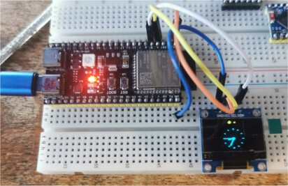

Greetings,
I have a new ESP32-S3-DevKitC-1 board, at least that's what I think it is (it has a tell-tale onboard addressable RGB LED on GPIO38). Right out of the box running the Arduino IDE v2.3.3 on a 14" Dell Latitude 7480 Core i7 laptop with Windows 11 Pro, I was able to blink a regular Red Led. Next I bought a bag of 0.96" I2C SSD1306 white OLED displays that I will eventually need in my project. The first step for me was to get the 0.96" I2C OLED displays working. I have been able to use the same I2C OLED displays with the previous version ESP32 DevKitC v4 board.
I know the ESP32-S3-DevKitC-1 board has two native I2C ports, and that I can use most any two GPIO pins for SCL and SDA. So I studied some tutorials on Rui Santos' excellent RANDOM NERD TUTORIALS site:
  1. ESP32: I2C Scanner (Arduino IDE) – Finding the Address of I2C Devices
  1. ESP32 I2C Communication: Set Pins, Multiple Bus Interfaces and Peripherals (Arduino IDE)
The one thing I am missing is what the default GPIO pins are used for the two default I2C ports on the ESP32-S3-DevKitC-1 board. But I don't think that should matter, I will just pick two GPIO pins and use those in the I2C scanner sketch. So I chose to use GPIO4 for SCL, and GPIO5 for SDA. Here is my I2C bus scanner sketch modified for those two I2C SCL and SDA pins. The SCL and SDA pins on the OLED display has on board 3.9K pull-up resistors. The I2C scanner sketch compiles without errors or warnings. But it always just prints "Scanning... No I2C devices found" on the Serial Monitor. There's a schematic in the header comments of the sketch below. I must be doing something dumb. Anyone spot something wrong? Thanks, David

@horace, thank you for your help. But...
Are you CERTAIN you are using an ESP32-S3-DevKitC-1 board when you say you successfully tested the I2C scanner on the I2C OLED board?
I moved from the troublesome ESP32-S3-DevKitC-1 board over to an older ESP32-DevKitC-V4 board and the I2C scanner immediately found the I2C OLED display at address 0x3C, just like your results.
But when I move back to the ESP32-S3-DevKitC-1 board, the I2C scan never works. In the Serial Terminal it just reports:
Scanning...
When I am using the ESP32-S3-DevKitC-1 board in Arduino IDE v2.3.3 I must set the following:
Tools > Board: "ESP32S3 Dev Module"
Tools > Port: "COM7" <- This is how the ESP32-S3's USB port (not UART port) enumerates
Tools > USB CDC On Boot: "Enabled" <- With the ESP32-S3 only, this must be "Enabled" for the IDE's Serial Monitor to work
Note: Without the USB CDC On Boot: set to "Enabled", the Serial Monitor in the Arduino IDE does not work with the ESP32-S3-DevKitC-1 board. But the Serial Monitor with the ESP32-DevKitC-V4 works regardless of how the USB CDC On Boot: is set.

@sonofcy said: "ESP32-S3-DevKitC-1? What board are you picking in the Boards menu, I find NO match."
Tools > Port: "COM7" <- My board shows up as COM7 when plugged in to the USB-C port labeled USB (not labeled UART)
Tools > Use CDC On Boot: "Enabled" <- If Disabled, the Tools > Serial Monitor does not work
In Arduino IDE v2.3.3 running in Windows 11 Pro, those settings above allow me to program my ESP32-S3-DevKitC-1 boards with a simple Blink example.

On that esp32 variant I guess you are aware that the labelling of the pins is under the pin. Could it be as simple as that?
@anon85221860: (Profile - runaway_pancake - Arduino Forum)
YOU SOLVED IT, THANK YOU!
      ESP32-S3 I2C Scanner
     OLED          ESP32-S3
 |       GND|----|GND       |
 |       VCC|----|3V3       |
 |       SCL|----|GPIO9     |
 |       SDA|----|GPIO8     |
Posted by Rui Santos: https://randomnerdtutorials.com/esp32-s3-devkitc-pinout-guide/
I2C: When using the ESP32-S3 with the Arduino IDE, these are the ESP32 I2C default pins:
GPIO 8 (SDA)
GPIO 9 (SCL)
Select these two pins like this in your sketch:
//Wire.begin(I2C_SDA, I2C_SCL);
  Wire.begin(8, 9);
Serial Monitor says:
Scanning...
I2C device found at address 0x3C
Hardware:
ESP32-S3-DevKitC-1: https://www.amazon.com/dp/B0D9W4Y3F3
0.96" White SSD1306 I2C OLED Display: https://www.amazon.com/dp/B09T6SJBV5
