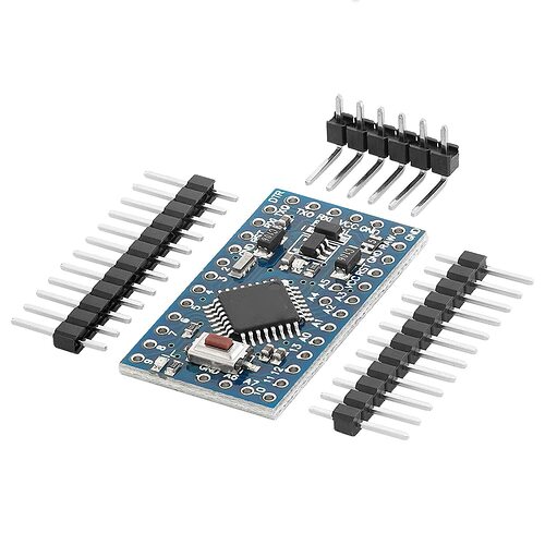

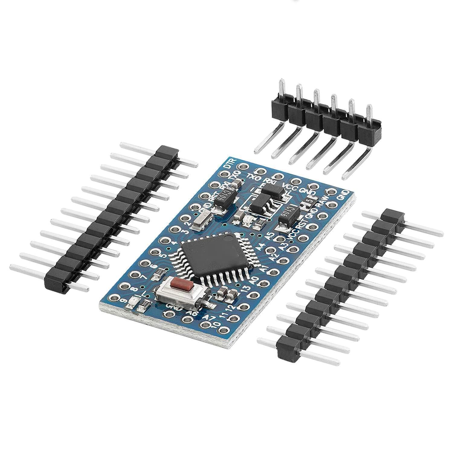

Im using a Pro Mini i got off amazon
had a fair bit of trouble with it until i read one of the comments on amazon saying it was actually a 3.3v 8Mhz board and when i tried that it recognised it on COM3 and started letting me upload sketches. I am running 5v into it - when i run 3.3v into it (by changing the flip over on my USB to Serial Converter) i loose the blocks along the top and ive checked the voltage going to the LCD and its sitting at 4.8v

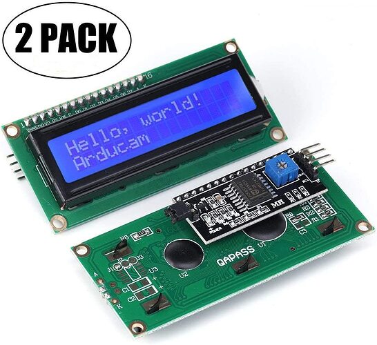

Im using this LCD (ive tried both and having the same problem with each of them - ive also checked the chip as per the notes in the description and can confirm its the PCF8574T chip with 0x27 Default address.

Can you post photos of the LCD so we can see the wiring and solder joints? And how it is wired to the Arduino.
The "Dupont" wires from China are known to be faulty on occasion.
The I²C backpack already has the pull-up resistors on it. The sketch is clearly and unambiguously telling you that the SCL connection to A5 is missing. If you think there is a wire connected to it, that wire is broken.
If not, the Pro Mini is defective (or a resistor is missing from the backpack - inspect it).

Had a look at the LCD and the pre-soldered i2c board was at an angle, so much so that the SCL leg was touching the R5 solder of the LCD board so bent it back up. what didnt make sense is the other LCD is completely flat (as it should be and it was throwing out the same response. i put the flat one back in anyway and kept the bent one as a spare.
I had a look at my Pro and the A5 connection and also noticed that the male connector i had used looked like it has sunk through the board! (see photo). so removed that and put in new connectors.
put it all back together again and boom! we have a working LCD.
Thanks so much for all your help and suggestions guys. im sure you will be hearing more from me :grimacing: now ive actually got the 'easy' hardware working and im moving onto the 'complicated' software part... buckle in.

thanks bill. i think you are right cause the LCD timer which counts up on your sketch was counting seconds twice as fast as it should have been.
ill try to get it to recognise the audrino with the 5v 16mhz processor selected in the IDE but up to now, the port selection is greyed out every time i use anything but the 3.3v 8mhz selection.
Problem sorted. Computer now recognises the 5v 16mhz board (previously saying the device malfunctioned and would sit as an unknown USB device if this selection was used and would grey out COM3 port select).
Ran the serial monitor again and was garbage coming out cause the baud was still set to 19200 changed it back to 9600 and everything has tested perfectly and the output passed all the test in the sketch and serial monitor. Clock on LCD is now counting in seconds as opposed to twice the speed.
