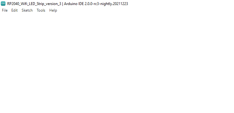

Hi.
After some minuts of working in IDE 2.0 RC3 the code area goes blank.
Sometimes is after a few minuts but it can vary to 1 hour or so.
You can open the menu's entries and select options but it doesn't trigger any action.
Anybody with the same problem?
Windows10 fully patched.
Here is an imagem:

Hi. Thanks for your reply.
This time the problem happened when I was openning a new IDE window.
After that the two windows got blank with menu commands not triggering any action.
Here is the output:

Thanks! This definitely looks interesting:

I had the same issue just now:
The menu works, the window behaves normal e.g. resize, move , minimize, .. but non of the menu options does react not even - Quit. Keyboard input is also ignored completely.

I got a capture of the PowerShell output, hundreds of repeats of -
root ERROR Error: Connection got disposed.
    at Object.dispose (D:\Program Files\Arduino IDE\resources\app\node_modules\vscode-jsonrpc\lib\main.js:904:25)
    at D:\Program Files\Arduino IDE\resources\app\node_modules\vscode-ws-jsonrpc\lib\socket\connection.js:14:41
    at CallbackList.invoke (D:\Program Files\Arduino IDE\resources\app\node_modules\vscode-jsonrpc\lib\events.js:62:39)
    at Emitter.fire (D:\Program Files\Arduino IDE\resources\app\node_modules\vscode-jsonrpc\lib\events.js:121:36)
    at closeHandler (D:\Program Files\Arduino IDE\resources\app\node_modules\vscode-jsonrpc\lib\main.js:240:26)
    at WebSocketMessageReader.fireClose (D:\Program Files\Arduino IDE\resources\app\node_modules\vscode-jsonrpc\lib\messageReader.js:111:27)
    at WebSocketMessageReader.fireClose (D:\Program Files\Arduino IDE\resources\app\node_modules\vscode-ws-jsonrpc\lib\socket\reader.js:67:19)
    at D:\Program Files\Arduino IDE\resources\app\node_modules\vscode-ws-jsonrpc\lib\socket\reader.js:24:18
root ERROR Uncaught Exception:

  2. Type the following command:
    Get-ChildItem -Path  C:\Users\user\AppData\Local\Arduino15\packages\builtin\tools\
  3. Press the Enter key.
  4. Right click on the title bar of the PowerShell window.
    This will open a context menu.
  5. Select Edit > Select All from the context menu.
    This will select all the text in the PowerShell window.
  6. Press Ctrl+C.
    This will copy the contents of the PowerShell window to the clipboard.
  7. Open a forum reply here by clicking the Reply button.
  8. Click the </> icon on the post composer toolbar.
    This will add the forum's code block markup (```) to your reply to make sure the error messages are correctly formatted.
    Code block
  9. Press Ctrl+V.
    This will paste the output into the code block.
  10. Move the cursor outside of the code block markup before you add any additional text to your reply.
  11. Click the Reply button to post the output.
Please let me know if you have any questions or problems while following those instructions.
PS C:\Program Files\Arduino IDE> C:\Users\user\AppData\Local\Arduino15\packages\builtin\tools\
C:\Users\user\AppData\Local\Arduino15\packages\builtin\tools\ : The term
'C:\Users\user\AppData\Local\Arduino15\packages\builtin\tools\' is not recognized as the name of a cmdlet, function,
script file, or operable program. Check the spelling of the name, or if a path was included, verify that the path is
correct and try again.
At line:1 char:1
+ C:\Users\user\AppData\Local\Arduino15\packages\builtin\tools\
    + CategoryInfo          : ObjectNotFound: (C:\Users\user\A...\builtin\tools\:String) [], CommandNotFoundException
    + FullyQualifiedErrorId : CommandNotFoundException
