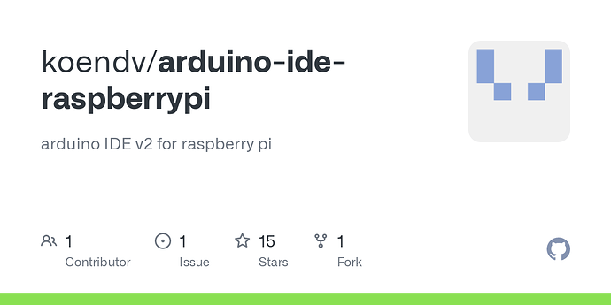

Hi @cnw4rwb. Currently Arduino does not distribute builds of Arduino IDE 2.x for the Linux ARM architecture of your Raspberry Pi. This means that the downloads available on the official "Software" page are expected to not work on the Raspberry Pi. They must be used on an x86 computer.
This deficiency is being tracked by the Arduino IDE developers here:
If you have a GitHub account, you can subscribe to that issue to get notifications of any new developments related to this subject.
There is an unofficial 3rd party build for Linux ARM if you want to give that a try:
Thank you,
Installed this one - AppImage - started up.
Baby steps with new software . . .
Ray.
You are welcome. I'm glad it is working now.
