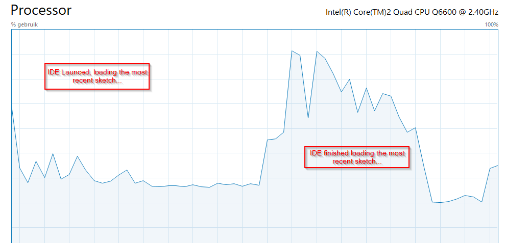

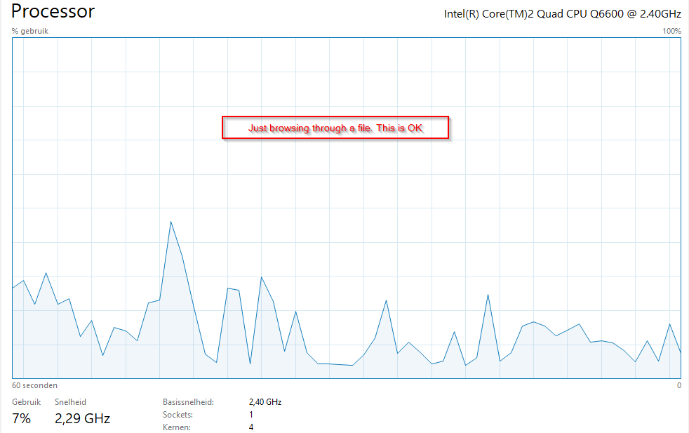

@ptilisch thanks for the prompt reply. I'm using IDE version 2.1.1, which to my knowledge is the latest and greatest (?) version. While my CPU is blowing me away the IDE is idle (or should be). I'm not compiling, loading, altering anything. Even when I'm back from refilling my coffee cup the CPU cooling is still screaming. My Desktop is nearing retirement age, but I've never seen this with other "intellsense" applications (like MS visual studio).
When I close the IDE, CPU usage drops instantly to about 3..4 %.
Even during compilation CPU usage looks OK
