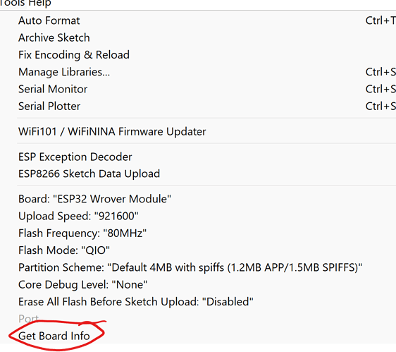

Even though I cannot upload a sketch, I can still obtain the board info. Does that bypass the serial connection? Also, does an external USB-serial adapter connect to the ICSP pins on the board, and then make the IDE functional again?

Only in Arduino IDE 1.x. Arduino IDE 2.x's Tools > Get Board Info feature only shows data from the board definition in boards.txt. So it does not provide any indication at all of the status of the hardware.

I wouldn't say the behavior of the feature in Arduino IDE 2.x is even necessarily wrong other than in the context of the Arduino IDE 1.x behavior. Arduino IDE 2.x's "Get Board Info" actually does what it says on the tin by providing the information about the selected board's definition. Arduino IDE 1.x's "Get Board Info" is more of "port info" than it is "board info". That said, I do think the port info is more useful.
I'm a little confused. The board info includes the SN, which doesn't come from boards.txt. It's obtained from the board, isn't it? I'm wondering if since the IDE can successfully obtain that, does it help clarify what is still working and what is not (in light of the fact that I cannot upload sketches via the IDE. Also, in playing with this and running avrdude from the command line, I've managed to trash the SN on the working board -- Get Board Info now returns "null" for its serial number. No other error messages and uploads still work, so am I correct in assuming I've managed to inadvertently overwrite the memory where the SN is stored?

In Arduino IDE 1.x, yes.
Not really. It tels us that the computer recognizes the USB device created by the ATmeaga16U2 chip on the Uno, but this fact is already indicated by the presence of a serial port for the board in Arduino IDE's Tools > Port menu. It gives more information about that USB device, but the information is not really relevant.
The VID/PID tells us which USB to serial adapter chip the board is using (e.g., Microchip ATmega16U2 vs WCH CH340), but that information is mostly only needed in the case where there is no port for a board due to missing drivers, and if there was no port then you couldn't use the "Get board info" feature anyway.
It is possible the serial number can be correlated to some manufacturing and distribution data that might be useful in the specific case where hardware design or firmware version is suspected as the cause (which I do not at all suspect), but that would require access to a hypothetical serial number database that only certain people (e.g., customer support staff) have access to, so not useful to the users or community helpers.
I don't know enough about the ATmega16U2 microcontroller that provides this information (note that the information provided by the Arduino IDE 1.x "Get board info" feature comes exclusively from the USB chip on the board, not the primary ATmega328P microcontroller) to say whether or not that is possible. If the uploads are working I wouldn't worry about it.
