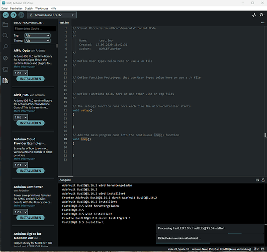

I had an IDE update from 2.3.3 to 2.3.4 and at the same time libraries wanted an update. I agreed to the IDE update, IDE restarted and then 2 libraries update processes came at the same time and wanted to start. ??? Of course they interfered with each other. Waiting did not help. I closed the IDE and then the libraries were installed. I experience this very often that suddenly a window opens twice at the same time for an update of the libraries. You can't seem to get a handle on it.

Now the IDE 2.3.4 hangs when updating the libraries. The window says FastLED is installed. However, the process does not end.

I also experience this problem sometimes. Unfortunately it seems to only occur intermittently and under specific conditions, which makes it difficult to investigate. For example, I experience it when I use the IDE with my ridiculous 32 GB collection of 90 different boards platforms installed, but when I switch to a more realistic environment with only a dozen platforms then I can no longer reproduce the fault.
And when I enable the debug logging that would give me some idea of what is happening, I can no longer reproduce the fault.
And when I run the same commands with Arduino CLI directly (which is the tool that actually performs the library updates for Arduino IDE under the hood), I can no longer reproduce the fault.
A very difficult to pin down bug! I have made multiple attempts at investigating it, but previously I didn't take it very seriously because we had never received any reports from users who were affected.
I can provide you with instructions for a workaround:
  1. When you see the "Updates are available for some of your libraries" notification, click the "INSTALL MANUALLY" button instead of the "UPDATE ALL" button.
    Library Manager will open, with a list of the updatable libraries.
  2. Click the "UPDATE" button on the first of the entries in Library Manager for a library you wish to update.
  3. Wait for the update to finish, as indicated by the appearance of a "Successfully installed library ..." notification.
  4. Repeat steps (2)-(3) until you have updated all the libraries you wish to update.
I find that when I update each of the libraries separately like this, instead of all in one go as occurs when you click the "UPDATE ALL" button in the notification, I never encounter the update process hang.
