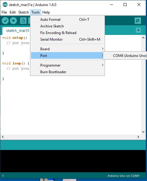

IDE showing two different Com ports

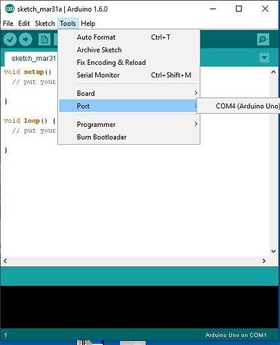

Arduino Uno and Windows 10 Device Manager are showing different port connections. There is only one choice in the IDE > tools > port, being Com4. However at the bottom of the IDE it says "Arduino Uno on Com1"
In Windows device manager under ports it shows Arduino Uno being connected to Com4. Com4 is the only port showing up in device manager > ports so I cannot upload any sketches at all and get this error with verbose output. Can anyone help me please. I am using an old version 1.6.0 but this also happens with the latest version too. I need the older version for a specific project.

Did you actually select com4 in the Ports menu? Just because it’s the only port listed doesn’t mean that the ide will select it automatically for you.

When I click ports in the IDE, Com4 is the only port available. I will post the error output that I am getting in the morning and thanks for the replies gents.

OP did not :wink: Still shows COM1 in the status bar at the bottom of the IDE

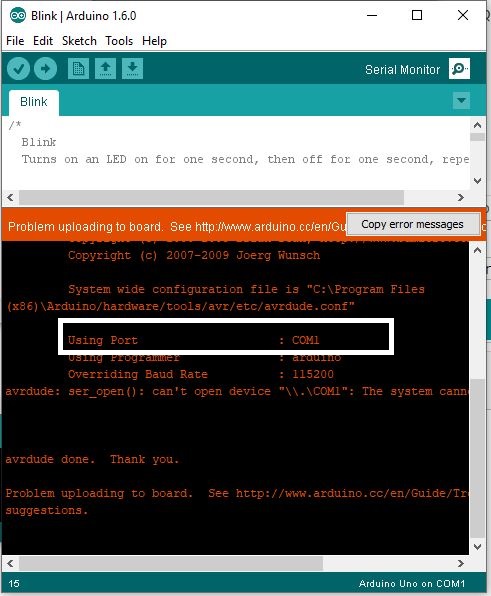

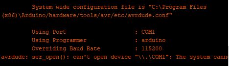

Well actually when I click Ports in the IDE only Com4 shows which is the port that Windows shows in device manager. Refer to my two images :slight_smile: There are no other ports available to select. Error message with verbose output enabled for upload is
Arduino: 1.6.0 (Windows 8), Board: "Arduino Uno"
Sketch uses 1,030 bytes (3%) of program storage space. Maximum is 32,256 bytes.
Global variables use 9 bytes (0%) of dynamic memory, leaving 2,039 bytes for local variables. Maximum is 2,048 bytes.
C:\Program Files (x86)\Arduino/hardware/tools/avr/bin/avrdude -CC:\Program Files (x86)\Arduino/hardware/tools/avr/etc/avrdude.conf -v -patmega328p -carduino -PCOM1 -b115200 -D -Uflash:w:C:\Users\PETERN~1\AppData\Local\Temp\build3931605540031484721.tmp/Blink.cpp.hex:i
avrdude: Version 6.0.1, compiled on Apr  3 2014 at 23:12:16
         Copyright (c) 2007-2009 Joerg Wunsch
         System wide configuration file is "C:\Program Files (x86)\Arduino/hardware/tools/avr/etc/avrdude.conf"
         Using Port                    : COM1
         Using Programmer              : arduino
         Overriding Baud Rate          : 115200
avrdude: ser_open(): can't open device "\\.\COM1": The system cannot find the file specified.
avrdude done.  Thank you.
Problem uploading to board.  See http://www.arduino.cc/en/Guide/Troubleshooting#upload for suggestions.

The way that I see it, for some reason the IDE is expecting to see the UNO on COM1 whereas it is on Com4 I.E - "avrdude: ser_open(): can't open device "\.\COM1": The system cannot find the file specified"

You will have to click on that port in the IDE menu.
sterretje:
Sorry not understanding. If I click on ports in the IDE, Com4 is the only one available. If I click on Com4 nothing else is made available but from my recollection nothing ever was. I haven't used all of this for about 18 months but I am sure that my memory isn't that bad :slight_smile: I even went into device manager, right clicked on Com4 > Properties > Port settings > Advanced and changed the Port to Com1 seeing as that seems to be a what was showing at the bottom of the IDE. Still compiles OK but this error on upload
