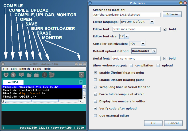

I use the IDE a lot myself believe it or not. I use version "1.0.6" which is a heavily hacked 1.0.5.
It's got features I need (unlike the stock IDE)
(click pic for larger)

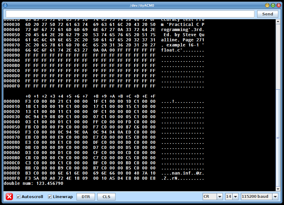

Another pic: The serial monitor. Note the control buttons on the bottom: Left to right:
Close window, Autoscroll ON/OFF, Linewrap ON/OFF, DTR (reboot Arduino), CLS (clear display), CR/LF/CRLF setecl, Serial font size and Serial baud rate (all operate in real time and saved in Preferences (no need to restart the IDE).
