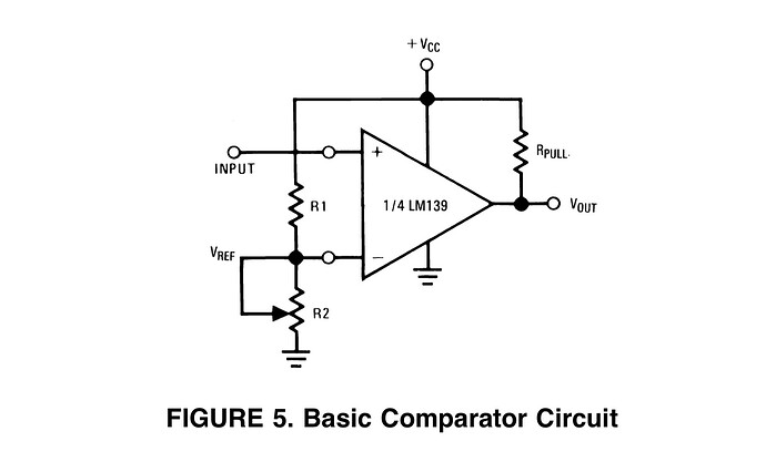

To condition the signal, suggest using a voltage comparator like the LM339.

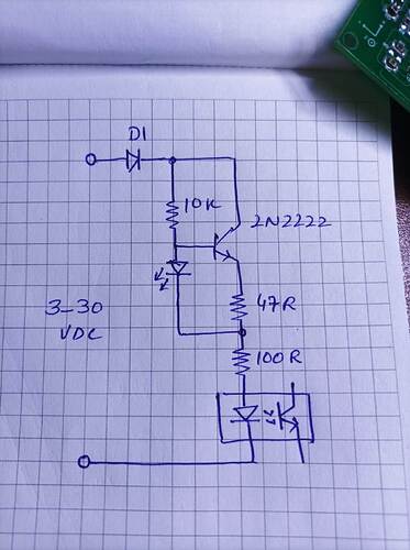

This is constant current circuit which i used many times. just i forgot the correct position of 47R and 100R. so better change positions if circuit does not work. it was confirm working from 5 to 30 volts. not sure for 3.3 volts. give it a try
LED on base is not for light but part of constant current source.
If reverse polarity protection is not needed then remove diode. it will surely start working from 3 volts then.
  • For the comparator circuit, the starting point would be this circuit.
  • A zener diode on the input can limit the input voltage to say 5v maximum.
  • Hysteresis can be added but probably not needed in this situation.
  • The LM339 will need a power supply, 5V to 36V will do.
  • Adjust R2 for the trigger point.

  • As long as there is some voltage (ex: 1.5v) left after the bridge, the LM339 circuit should work well.
  • R2 can be a ten turn 10k potentiometer with R1 selected as needed, start with 10k.
  • As mentioned, Vcc can be 5v to 30v, suggest 5v.
  • There are 4 comparators in one I.C. hence a second stage can be used if a filter is necessary.

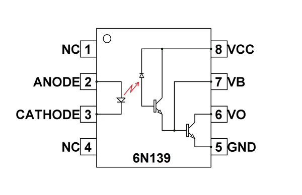

  • Some 25 years back did the same thing, different application.
  • The comparator approach worked perfectly.
  • Think a 6N139 was used but no big difference.

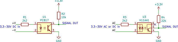

So overly complicated solutions! It can be done so much simpler: just get a suitable series resistor in the input, and a weak enough pull-up in the output. Unfortunately not for the 6n136, though, you'll have to use a cheaper part.
If you want AC, you can use an AC in DC out type of optocoupler, such as the H11AA1.
For the 6n137: absolute maximum forward current for the LED is 20 mA, but its minimum is 5 mA. If you want <20 mA at 30V, use a 1k5 resistor, but then at 3.3V the current in the LED is just 1.3 mA, not enough for the 6n137 to switch on.
In case of the PC817, the story is very different.
Vf of the LED is 1.2V, CTR is at least 50% (for some versions up to 300% guaranteed).
Use a largish pull-up resistor, to limit the collector current. 10k gives 0.33 mA Ic at Vcc = 3.3V.
On the input side, a 2k2 series resistor. Now you have 13 mA at 30V, down to 0.95 mA at 3.3V.
This will work great with all signals under about 10 kHz. Higher frequencies may be a bit iffy.
For the H11AA1 the calculations are different as it's minimum CTR is just 20% but it its LEDs are rated up to a very high 60 mA. A weaker pull-up resistor of 22k would be the easiest solution - 0.15 mA Ic, which at 20% CTR needs >0.75 mA through the LED.
This is the simplest solution I can come up with.

Like I said no big difference.
Output is an output is an output. :wink:
