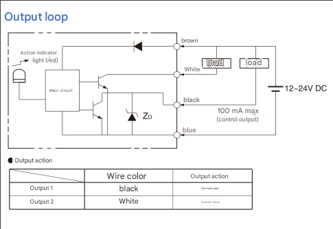

I am using this FGZUQL opto switch (http://www.fgzuql.com/productinfo/2598686.html) which have the following diagram:
Which is (probably not precisely) translated to (Actions are "Normally open" (upper), and "Normally closed" (lower):
I use white wire for output. Black is NC.

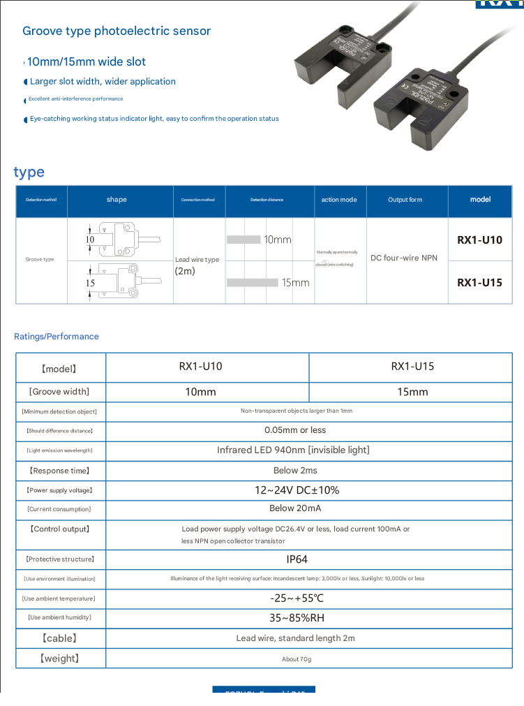

Here is (translated) spec:
As you can see those sensors are powered from 12 V. I have 24V source (for motor drivers) so I used the DC/DC converter: SCWN06B-12 Mean Well DC/DC converters, 6W - elpro Elektronik (24 to 12).

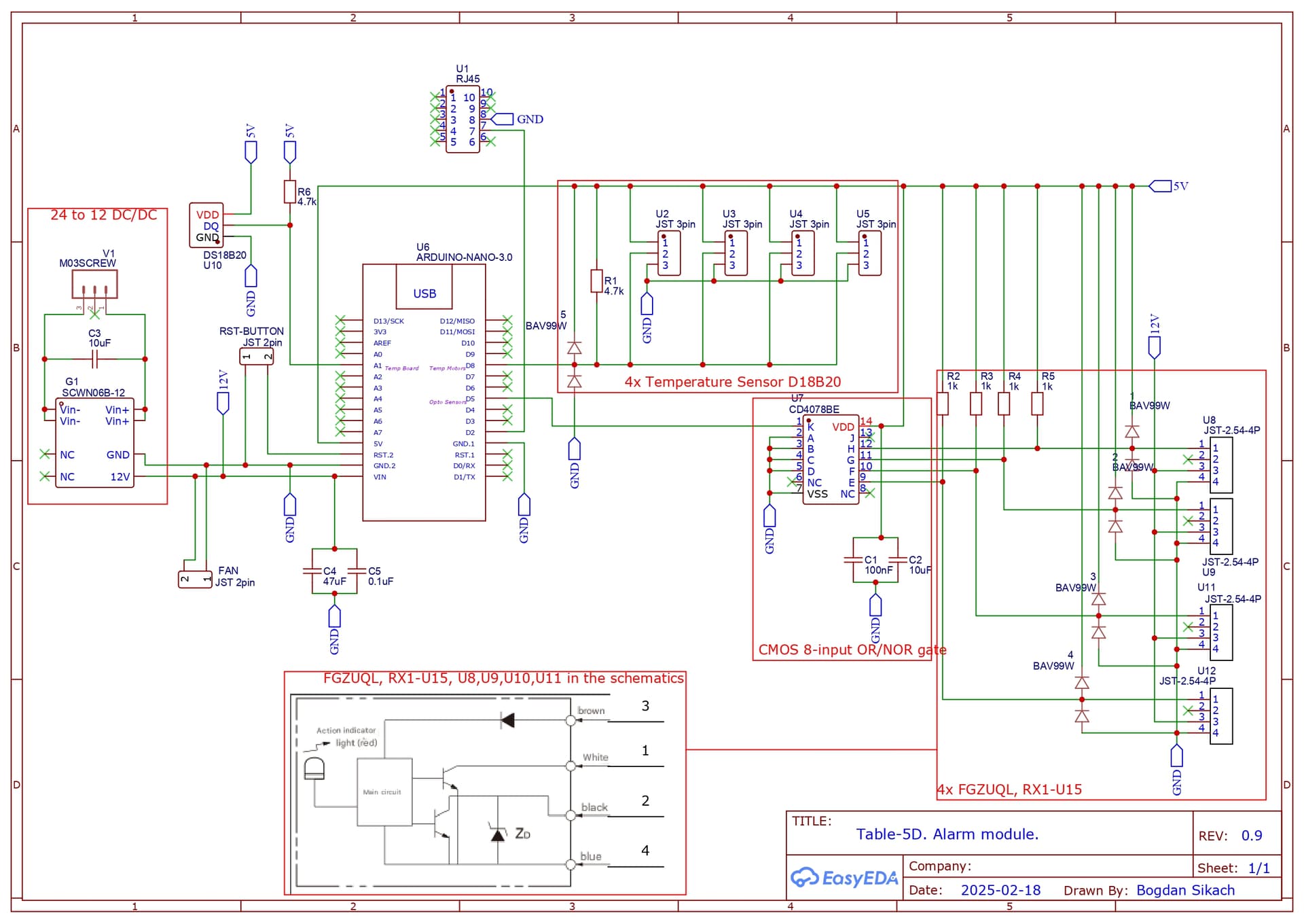

I have 4 sensors. Their outputs connected to the 4 inputs of 8-OR IC (with 4 other inputs connected to GND).
This is whole schematics. Opto switches are U8, U9, U10, U11 (on the right):
schematics.pdf (102.6 KB)
The problem
Everything works as expected. All sensors work. Temperature is read, and the opto switches are also working as expected. However, after some up time (2-4 hours) arduino's loop just stops. Reset button brings it to live, and again 2-4 hours and loop is stopped. I did some investigation and came to the conclusion that the culprit is opto switches: with them disconnected it works more than 24 ours without stopping the loop. Also I am making a simpler board with just arduino and sensors to confirm the problem caused by them, but now I am asking why it might be so ? I suspect it is because I power sensors from 12V, but the output is connected to 5V from arduino. But judging from the diagram it open collector output. I am out of ideas. Could you please help me here ?

Where is the FGZUQL located on your schematic?
I can't make out the part number of the CD40 chip (U7). Is it a multiplexer? I see it's powered with 5V. Are you putting a 12V signal on it's input pins?

I updated the schematics. The thing is I have connectors on the board to connect the sensors. They are in the right bottom corner.
Updated also. It is CMOS 8-input OR/NOR gate. I power it from 5V from arduino indeed, but the input is also 5V as you can see: the inputs are 1k pulled up to 5V. And if sensor's open collector is closed it becomes 0V.
I added the spec of the sensor also. I am wondering why only one output is called "control" and 100mA maximum rating is presented only for that.
Has anybody actually looked at the schematic.
It should have been posted as a jpg.
Note that the power supply consists of a 24V to 12V DC-DC converter, that 12v is fed into the Nano Vin.
Most the peripherals are supplied by the 5V linear regulator on the Nano board.
Even 100mA of load will produce.
P = V x I = (12 - 5) x 0.1 = 0.7W.
I would say the regulator is going into thermal shutdown.
If the fault did not occur with the four sensors disconnected, its obvious.
Instead of 24V to 12V DC-DC converter, use a 24V to 5V Dc-DC converter and feed 5V DIRECTY into the Nano 5V pin and to the peripherals.
Use your DMM and monitor the 5V supply you have now and see what happens when your project fails.
What else is the 5V supply powering?

The reason for open circuit collector NPN outputs is so you can power the sensor on a different/higher voltage than the control voltage on the output.
