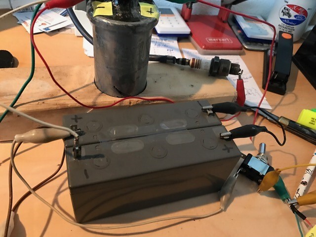

Hi I'm trying to drive my ignition coil with arduino. I'm using the following setup as seen in the picture.
I'm using the following components:
-ne555 as a timer
-mosfet IRF640
Is the ne555 timer oke or do I need to use another component? (4n35?)

To an unaided eye it's just a spludge of components...
please post a circuit diagam - then we might be able to help.

It appears you're trying to use the 555 as a mosfet driver, but no it does not appear to be connected correctly. I base this statement primarily on the fact that you appear to have the mosfet gate connected to pin 6 (on the 555) when it should be connected to pin 3.

Have you done any research on how to switch highly inductive circuits in particular auto ignition circuits.
Can you tell us your electronics, programming, arduino, hardware experience?
I cannot see any back EMF protection for the MOSFET, what criteria did you use for the MOSFET choice?
Although you are switching 12V, the primary of the coil will produce 500V or more when firing the sparkplug.

I do must me apologise for my first post that day. I don't have any experience with Arduino and carcoil ignition drivers. I found a schematic on the internet and start to try construct anything.Now I can't find that schematic anymore as I destroyed the original...
Surfing on the internet I just learned that in the case of this schematic that I used, it was totally wrong!
It has a Photocoupler as a "timer" or so, and I thouged it was a 555. That does not combine!

The way to proceed is find the datasheet for an IGBT designed for automotive ignition coil driving,
then use the example circuit from that datasheet. Use an IGBT, not MOSFET, for high voltage, much
less likely to expode it. IGBTs for ignition are capable of 10V gate drive, most IGBTs need 15V.
Or make life easy and use a specialized module like this:
