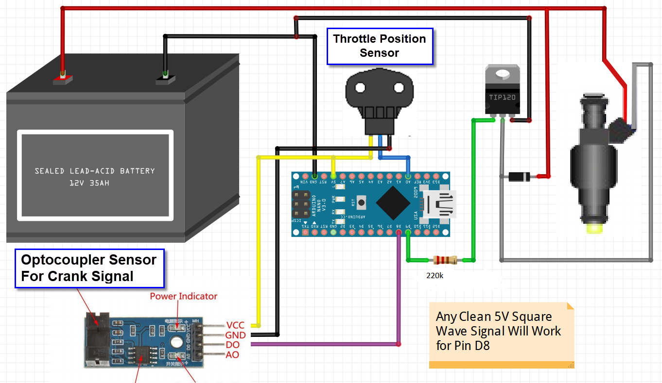

add a transistor that will handle the current and the Arduino pin can control that transistor, which i did. i use a tip 120 for testing.
My igniter is same as the picture

I see two things wrong with your diagram.
220K ohms is way to big try 470 ohms
Your coil has no ground return
Can your multimeter measure a pulse that is 100 microseconds long?
i changed the values for triggering time. it all works well now.
