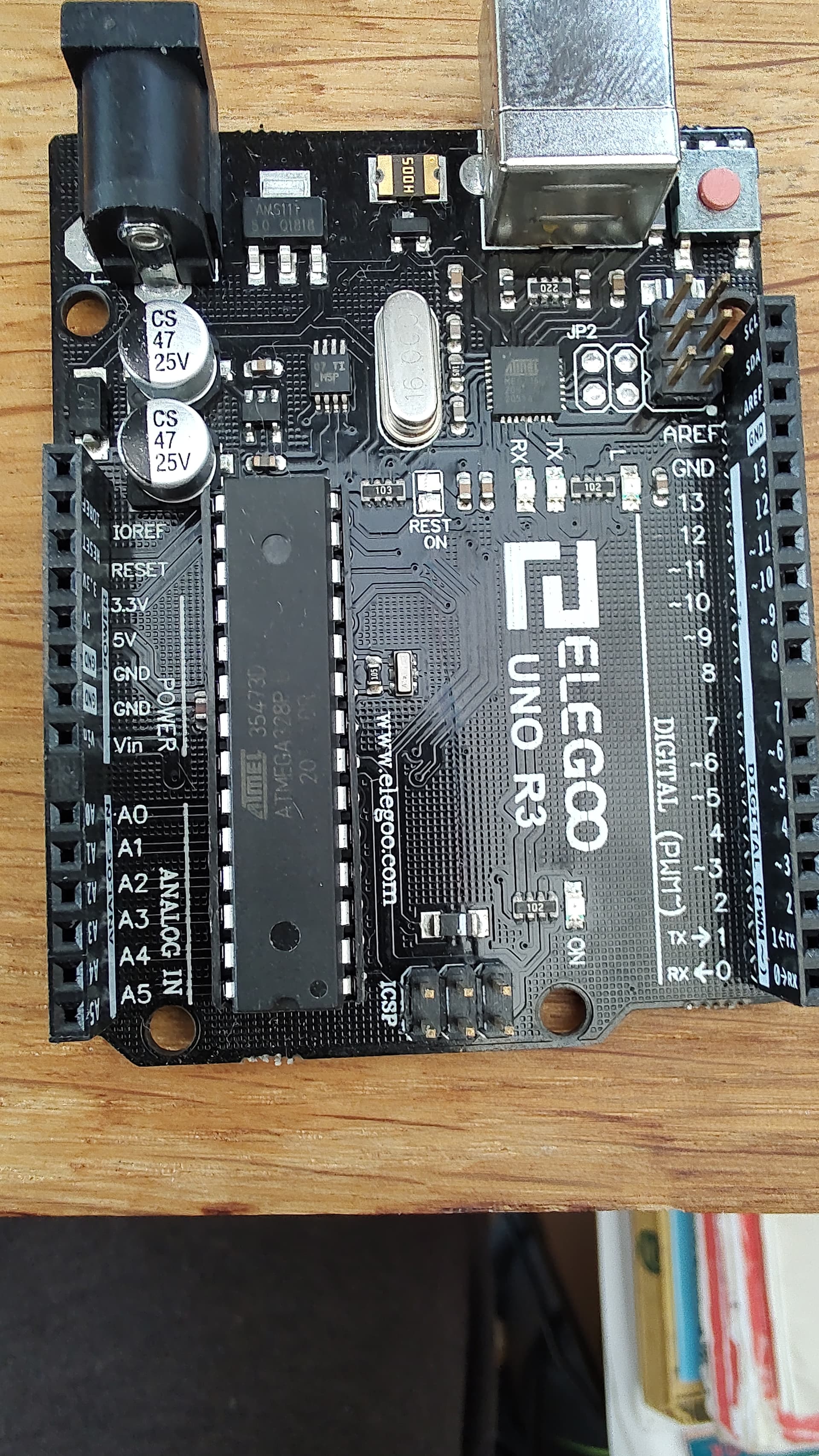

Hello
Does anyone have experience with this TFT Shield.
Using Adafruits examples, the graphics display fine.
But when I try and use the touchscreen, nothing.
I have tried setting YP=A1, XM=A2, YM=7 & XP=6 (#define TFT_YP A1)
my initial setup includes...
#include <TouchScreen.h>
#include <Adafruit_GFX.h>
#include <Adafruit_ILI9341.h> // include Adafruit ILI9341 TFT library
#include <MCUFRIEND_kbv.h>
MCUFRIEND_kbv tft;
// The STMPE610 uses hardware SPI on the shield, and #8
#define STMPE_CS 8
Adafruit_STMPE610 ts = Adafruit_STMPE610(STMPE_CS);
// The display also uses hardware SPI, plus #9 & #10
#define TFT_CS 10
#define TFT_DC 9
//Adafruit_ILI9341 tft = Adafruit_ILI9341(TFT_CS, TFT_DC);
#define TFT_YP A1
#define TFT_XM A2
#define TFT_YM 7
#define TFT_XP 6
Many thanks
