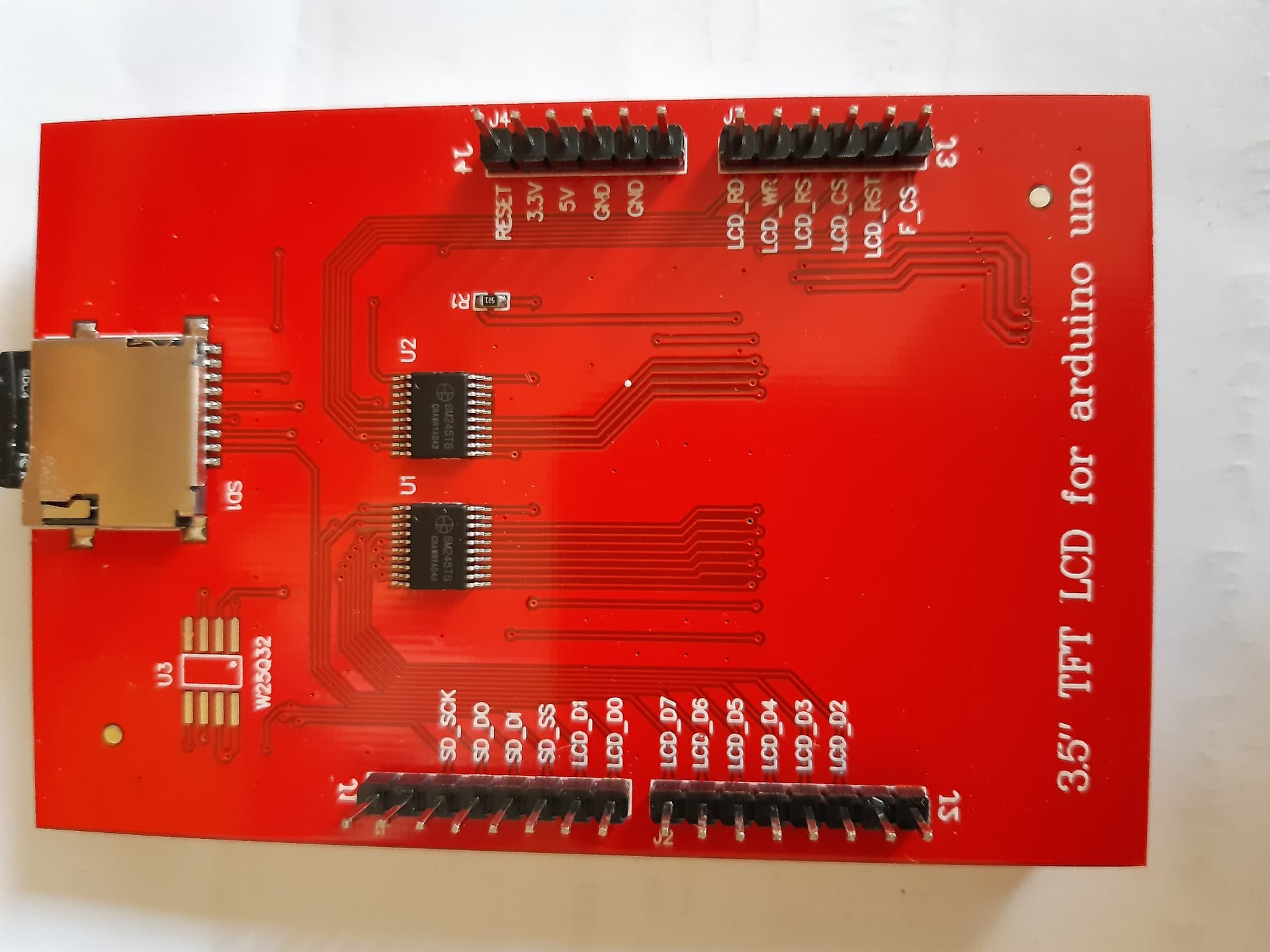

If you post a link to your display, or a picture of the backside, then we would know if it is a MCUFriend style TFT for UNO. And if the same modification as in https://forum.arduino.cc/t/3-5-tft-lcd-ili9488-display-is-having-mirrored-text/1129159 can be applied, just on a different code line.

The controller of your display might be an ILI9487. MCUFriend_kbv handles this the same as ILI9488. Did you ever check the ID reported by Read_ID() ?
You could check to force ID of ID_9488.
