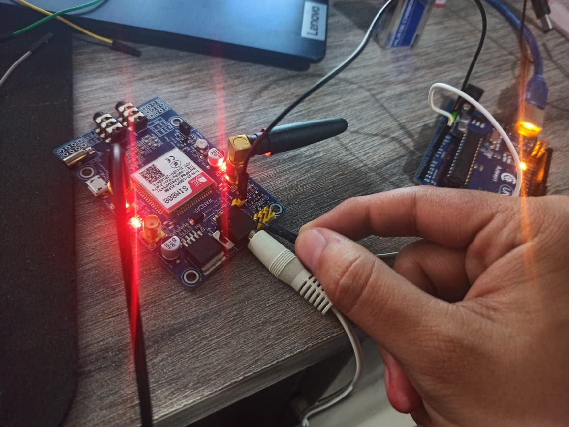

I'm getting Sim 808 init error
I recently bought a SIM 808 EVB-V3.2 module and I wanted to do a basic test.
I made use of an example code from the DFRobot_sim808.h library
From the following code I want to recieve a call from the sim 808 module

but when I run my program I am getting the "sim 808 init error"

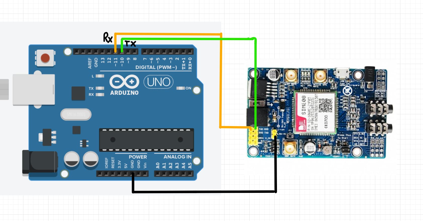

I am powering the module with 9V 2A, and my connections are like this:
Physical connections:
I don't know why I am getting that error, the module seems it's recognizing the Sim card because the second led is blinking every 3 seconds.
Any suggestion would be very helpful
have a look at car-tracking-system-with-the-sim808-module - it appears to show different Arduino <> SIM connections to your circuit
The connections are the same
pin 10(TX) -> RX
PIN 11(RX) -> TX
I was looking at the diagram of the Mega which has pin connections 10 and 11 the other way around??
pin 11(TX) -> RX
PIN 10(RX) -> TX
maybe worth swopping the connections over?
I tried that and I'm getting the same :confused:
