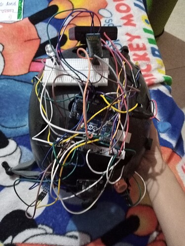

this app is part of a smart helmet me and my friend are making. It has two ir sensors to check if the driver is wearing the helmet, an alcohol sensor, a joystick to remotely control the phone ( answer, decline calls) three led. Two for the indicators and one alarm led. It also has an accelerometer for indicators and buzzer for alarm. I originally programmed the code in ardublock, so I don't think that it is syntax error. However , because of the lack of blocks in ardublock to fulfill all requirements, I switched to Arduino ide for some final editing

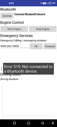

The start engine button works. The helmet starts the checks and rings alarm if necessary. But then communication stops working. Nither the phone or helmet recieve Bluetooth messages.

@Delta_G I am using an arduino uno the program is using around 20% of storage and memory. the code is working fine apart from Bluetooth communication at least. I also check for all the sensors they are all giving accurate readings the wiring is correct with the mapping of pins in the code there are no other issues power supply is normal 5 volts. The main components are on like a helmet that all strap together there and none of the wires are loose. Bluetooth hc05 wiring is correct. One way communication from phone to arduino is working
Is there communication from the the Arduino to the phone when using Serial Bluetooth Terminal app?
@cattledog Yes through the Bluetooth app, two way communication is working.
In that case, you certainly know to focus your efforts on the receiving side of the App inventor code.
Not an Arduino issue, and you might do better on the App Inventor forum for assistance.
