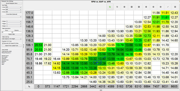

Ok so i am pretty new,(never wrote code be4 a month ago) i have my automotive automation project going now finally, data logger, keyless entry, remote start, hard cut rev limiter working together so far. Im not sure how to even describe what i want to do to someone who hasnt seen an afr data logging histogram, but basically i have 3 variables to compare. Manifold absolute pressure, ranges from 0 to 100
Rpm 0 to 6000
And air fuel ratio in lamda 0.45 to 2.
If you think of the table as a graph it would be
Rpm. Afr
Rpm. Afr
Rpm. Afr
Rpm. Afr.
Map map map map ++
Basically at this rpm and map pressure afr = x. Afr would be a running average in each cell. I hope i explained what im trying to accomplish well enough some1 can understand it🤦‍♂️ thanks any help or direction Would be appreciated.
Something like this?
How many columns and rows do you expect?
Are the values of the rows and columns evenly spaced?
so you have a 3D surface AFR = function(RPM, MAP)
what's the issue you are trying to solve? interpolate and guess the AFR value for a given couple (RPM; MAP) based on a number of samples (some dots on the surface)
Yes to red car. I would like map to go up in increments of 5 and rpm in increments of 200. So 30x 20. If thats what you mean by evenly spaced. Im still learning how to write code in general and havent used arrays yet. Ive done a bit of reading but couldnt phrase my question well enough to get the answers i was looking for. Ty for the reply. Could u point me towards some literature that might help me?
That would work as well but no guess work. It will be live data. I just want it plotted for easy analysis to tune my ve table

A 30x20 array is just defined as
int afr[30][20];
As your rpm and map are evenly split, for a given index you know the corresponding value
For example afr[3][5] would be for map=3x5 and rpm=5x200 (if both started at 0)

you define gloablly
const byte maxMap = 30;
const byte maxRPM = 20;
int afr[maxMap][maxRPM];
and if you have a way to get the data you iterate over something like this
int mapIndex;  // map increments of 5. the index is [0,29] ➜ map varies [0, 145]
int rpmIndex;  // // rpm increments of 200. the index is [0,19] ➜ map varies [0, 3800]
mapIndex = readMAP() / 5;            // function to get the MAP value from the serial port
rpmIndex = readRPM() / 200;          // function to get the RMP value from the serial port
afr[mapIndex][rpmIndex] = readAFR(); // function to get the corresponding AFR from the other serial port
PS: also the ESP32 has 3 hardware serial ports may be you don't need to use SoftwareSerial

is it right to say that at some point in time you get through serial ports a triplet (MAP, RPM, AFR) that are related and the process repeats and you get tons (600?) of those and you want to save that information.
could you show us what a dump of what the 50 first triplets look like?
Still learnin😂 and i can post a full copy was just saving space. Idk what u mean by triplet tbh. Rn it just prints each value as it reads it. Im actually changing it now though to instead print all 3 at once if that's what you mean? I know exactly nothing about micro controllers or code of any kind shape or form except what ive learned in the last month so this is all still very new to me. I work with my hands. Im good at building, fixing, creating things. Micro controllers just became a necessity to accomplish a goal if I'm honest.
What I call triplets was a set of the three values.
Can your code get them in variables all at the same time ?
That’s what you want to get into the array isn’t it?
