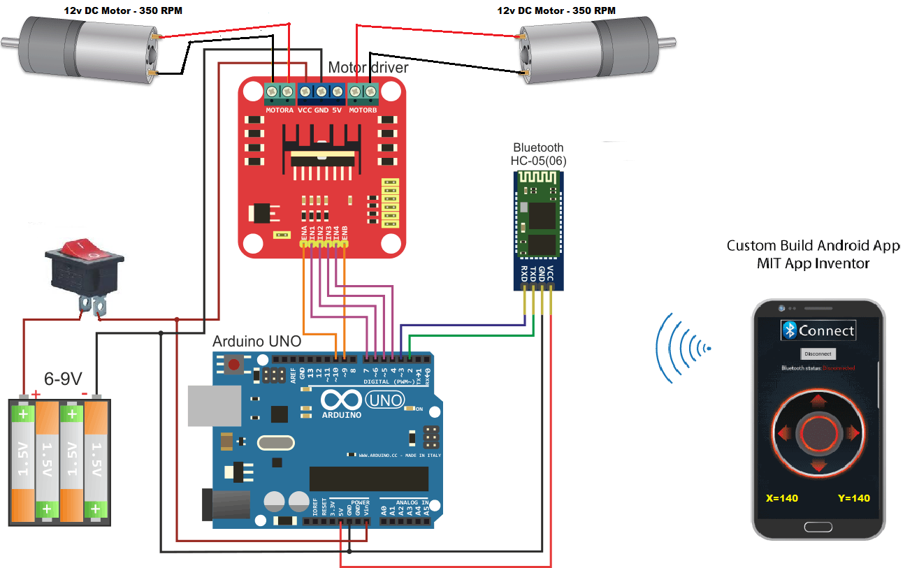

I'm new to using arduino and my group is doing a robotics study
Mod edit:
See also Multiple Sensors on GND and 5V
We dont really know much on how to connect or code anything but what im worrying right now is if one singke arduino can handle a lot of sensors and what it would look like in real life
This is what it will look like and i think we can handle that much but eventually we'll be adding some humidity sensor, soil moisture sensor(im not even sure what it would look like on a robot car), gps to track it while we control it, and a lot lot more which we havent discussed yet since theyre studying abt other sensors to add. This is a farming robot and we want to add more sensors for innovation so if anyone out there knows how to connect each component and wires and make a model(?), drawing(?) or idk illustration which shows the wiring and components, I woukd really appreciate it

The first thing that I notice is that you are using 12V motors but only have a 6V-9V supply
As to adding more sensors in the future then perhaps you should use an Arduino with more pins such as the Mega 2560

First, the motors need a 12 V battery. If you add more sensors you will need a board with more pins. Either a big board like a Mega2560 or an esp32.
When you start to build, just do one motor, then two, then 4, then start adding sensors.
you show an Android app controlling the farming robot using Bluetooth
Bluetooth has a very limited range so is probably not suitable
consider use something with a longer range, e.g. a HC-12 or LoRa P2P
for the remote controller you could then use something such as a ESP32-Cheap-Yellow-Display
If you want or need more pins on an Arduino you can also add a port expander chip like the MCP23S17 (spi interface) or the MCP23O17 (I2C interface).
You also might struggle with the Bluetooth as the HC05 will produce the old type of Bluetooth. Where as the Android App might produce Bluetooth Low Energy (BLE) signals which are not compatible with the old HC-05 sort of Bluetooth.

thank u for this!! we had a problem with the limited range
I forgot to mention but we are replacing the battery with a solar panel, is 12v solar panel the same?
Solar panels are usually used together with battery. So if you go with solar, you need compatible panel, solar charge controller and battery.
