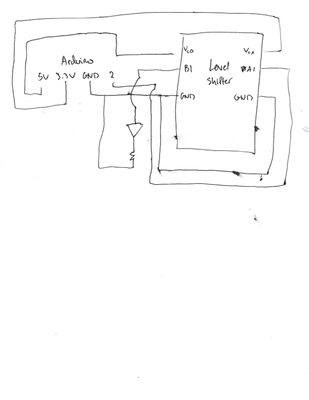

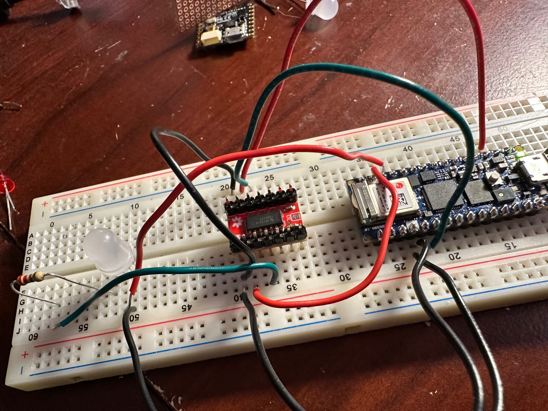

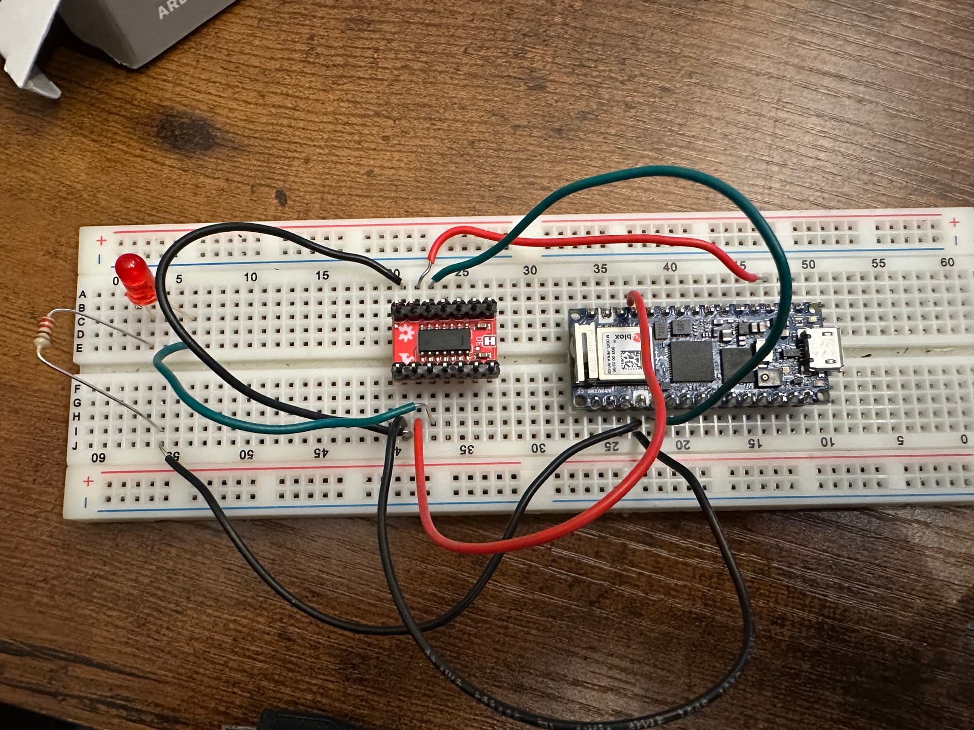

I'm having trouble getting the Sparkfun TXB0104 to work. I have the following connections, which if implemented properly the LED should be on when pin 2 is HIGH, however it is not. Any guidance would be greatly appreciated.
The level shifter is not designed for high (or even LED) current loads, and you don't need one for an LED. Just choose a resistor that limits the LED current to a safe value for the port pin of whatever MCU is on the board you are using.
What IS that board?
I don't know what's the purpose of the level shifter here. Some testing?
Anyway you give 3.3V on the right side together with 5V signal from arduino?
What board is it?
I'm just testing the level shifter with a standard LED before implementing a diffused LED that has a 5V operating voltage. The board used is an RP2040 which logic is only 3.3V.

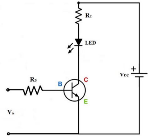

Any NPN transistor plus a 5K base resistor to the port pin would work.

Anyway, logic level shifter is for logic level signals, not for powering anything (not even that red LED).
It's not a boost converter.

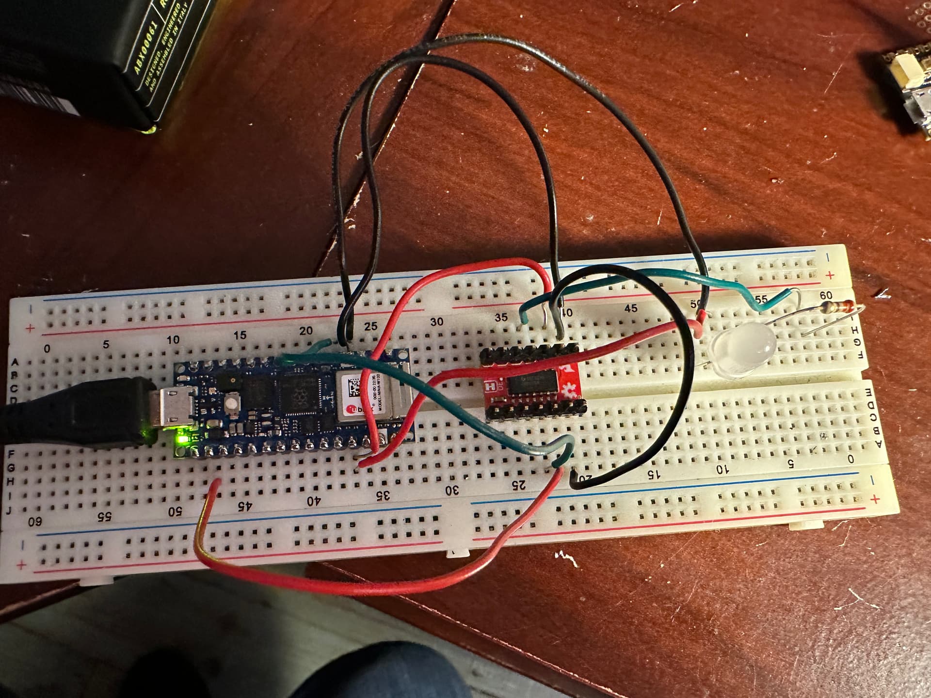

As for the WS2812, I'm still having trouble implementing. Attached are some photos and the code.

You have not provided enough information about your setup or the problem. The photos are of marginal usefulness.

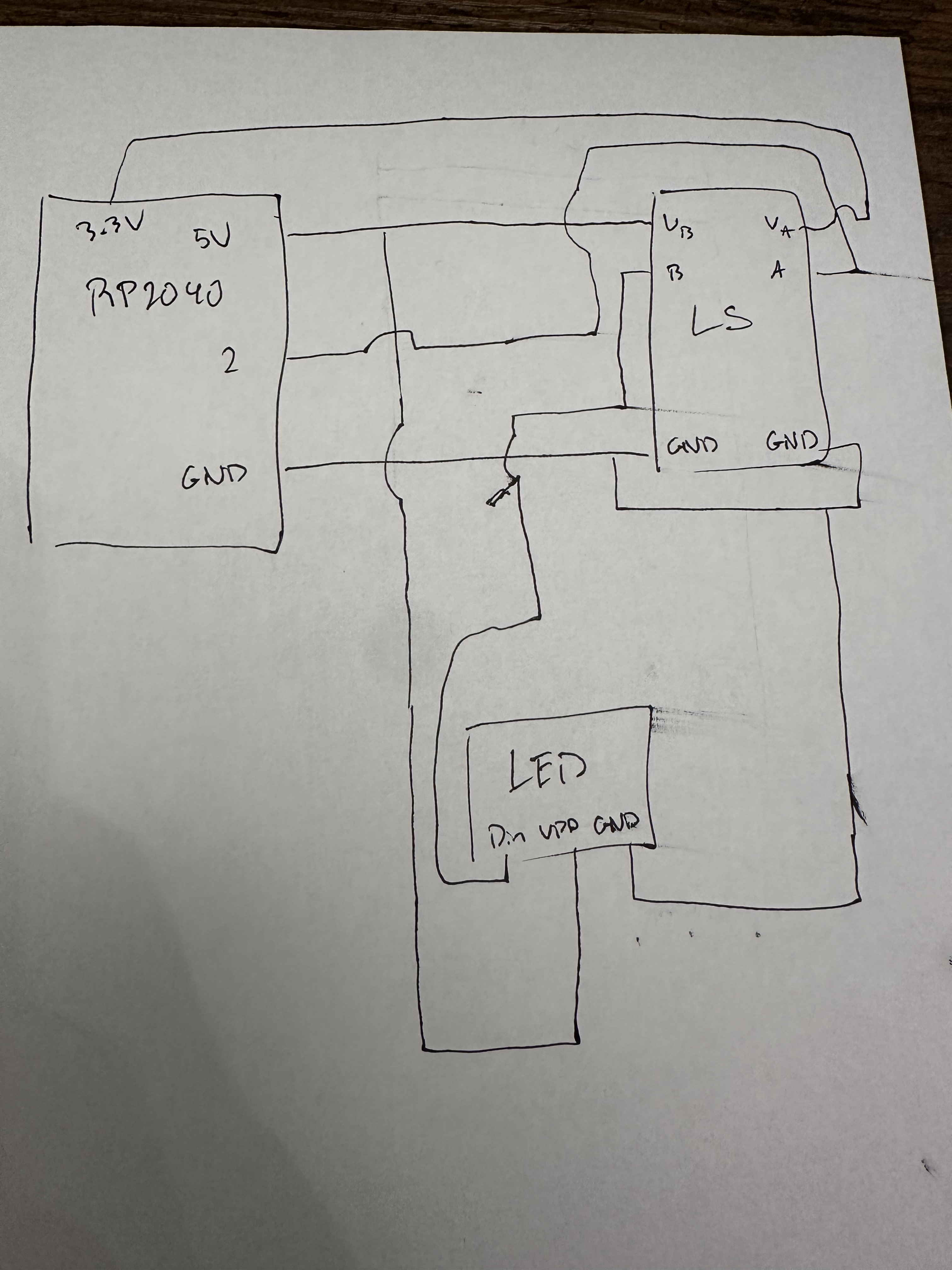

My apologies. I am trying to connect a WS2812 diffused LED to an Arduino RP2040 using a level shifter, and the LED is not blinking as intended. The code and circuit images are included mentioned above, and a diagram is below.
Logic level shifters are generally slow, and I don't know of an example of using a logic level shifter with the WS2812. If you are following a tutorial, post a link to it.

  • Why are the PCB pins not fully pushed into the breadboard?
  • Why are the plastic spacers on top of the board? They should be under, like they are in the RP2040 board.
  • Are those PCB header pins soldered to the board?
Not all of them. And I have several examples.
The very simple logic level shifters made with FETs and pull-up resistors are indeed slow. They work ok when shifting i2c bus signals. They will work with ws2812, but only with luck. I tried it once and it did kinda work but it was right on the edge. If I moved my hand near the circuit, the LEDs would go crazy. Checking the input and output signals with a 'scope, I could see that the shifter was turning a nice clean square-edged signal into a sawtooth mess. So I would not recommend that type of shifter for WS2812 or any similar type of LED.
But the shifter shown in the photos is not a simple FET/resistor type, I think. I can't read the markings on the chip, but it might be a chip dedicated for level shifting and should be able to source a decent amount of current and work at high speeds.

I looked up the TXB0104 (data sheet) and it is in fact very fast, bidirectional and has totem-pole drivers capable of sourcing or sinking 50 mA absolute maximum.
So, if the headers were properly soldered and the wiring correct, to it should work with the WS2812.
Note: the TXB0104 has the very nice feature of Vcc isolation. Looks like a great part, if one must use level shifting.
