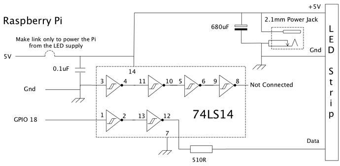

I was able to connect the mosfet logic level shifter, is there a guide on how to connect the 74HC14 ?
will the 74HC14 fit on a breadboard or it is too small for a breadboard?
edit how can I know that I am buying an original Texas Instruments and not a clone that may work worse than my mosfet logic level shifter?
Yes
Wire it like this:-

Wire it like this:-
I'm not able to read that schema.
Is there a more simple one that says where to connect pins in an Easter and less technical way?
Something like the one I posted on the first post
This might help you:-

sblantipodi:
The physical pin numbers are marked on the input and output of each element :wink:
Make sure to also connect power and ground (see the datasheet for full pinout)
