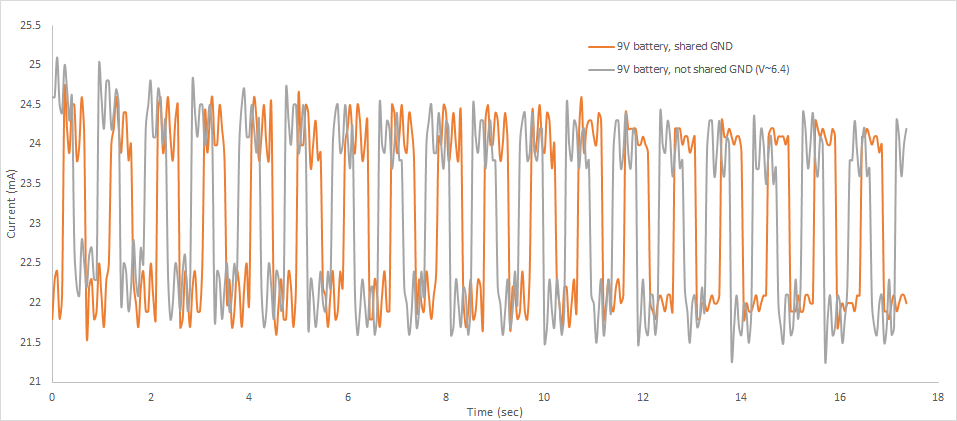

I tried hooking up an Arduino Nano with a 9V battery running a simple blink sketch, and measured the current draw. I wired it using a common ground as my schematic suggests, and also wired it with the 9V battery's GND going directly to the Arduino (and not being shared with the INA219 GND). According to the plot I made, the current values are pretty much the same despite the slight shift in the time axis since I didn't synchronize the graphs. But the major difference is that using a common ground allowed me to read the voltage in real-time as well. Otherwise, I had to switch the contacts of the INA219 (move the wire from Vin- to the INA219 GND) to read the voltage.
What's interesting is the voltage values seem to differ. When using the common gnd, I was reading voltages of about 6.15V. When using the other method, I was reading ~6.4V. Why would this be the case? The open-circuit voltage of the battery when hooking it up to a multimeter is approx. 6.75V
9volt battery as in smoke alarm battery.
They can't provide a lot of curent, and voltage will sag more and more under load as time goes on.
A blinking LED could make battery voltage hop up and down, something your DMM will largely ignore.
6.15/6.4volt from a primary 9volt block battery means the battery is already dead.
Note that the INA219 measures voltage on the +input only.
Leo..
