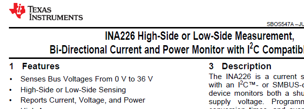

I wonder why that was recommended. The INA226 is designed for both high and low side current sensing.
Capture
Certainly the high side voltage cannot exceed 36V.
I may have not been clear enough in first post. My application requires maximum 42V on bus thus my interest in low side sensing.
