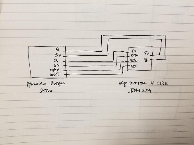

Please post a hand drawn wiring diagram, with pin numbers and parts clearly designated. Include the power and load connections being monitored. There is something seriously wrong.
I have no load on it currently. I can add a resistor and LED onto it for 3 volts but for now I am checking it by verifying that it can read out its manufacture ID which is stored in Register 0x3E based on the datasheet. This is the simplest to test the power sensor. The wiring diagram I have is also very simple SPI connection. Keep in mind that when I have the gnd pin connected it reads 0, but when I have it detached it reads the ID correctly. The ID is 8473 (ASCII) which is TI (char).

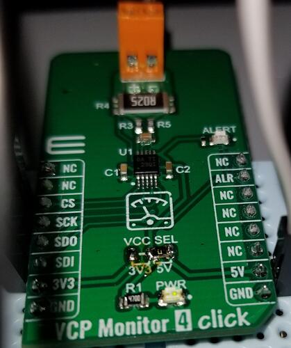

The VCP_Monitor_4 schematic shows that there is a jumper (JP1) for Vcc selection but In the picture it shows a zero ohm resistor soldered on the 3.3V side of a smd jumper.
Does your board have a 2 pin jumper?
It does not have a jumper. I de-soldered and soldered the zero ohm resistor onto the 5v side to use 5v.
It is simply incomprehensible how that could work without a ground connection.
Something else must be substituting for the ground reference, like the /CS connection. Which suggests a PCB fault, solder bridge, etc. Post a close up, focused photo of your soldering.

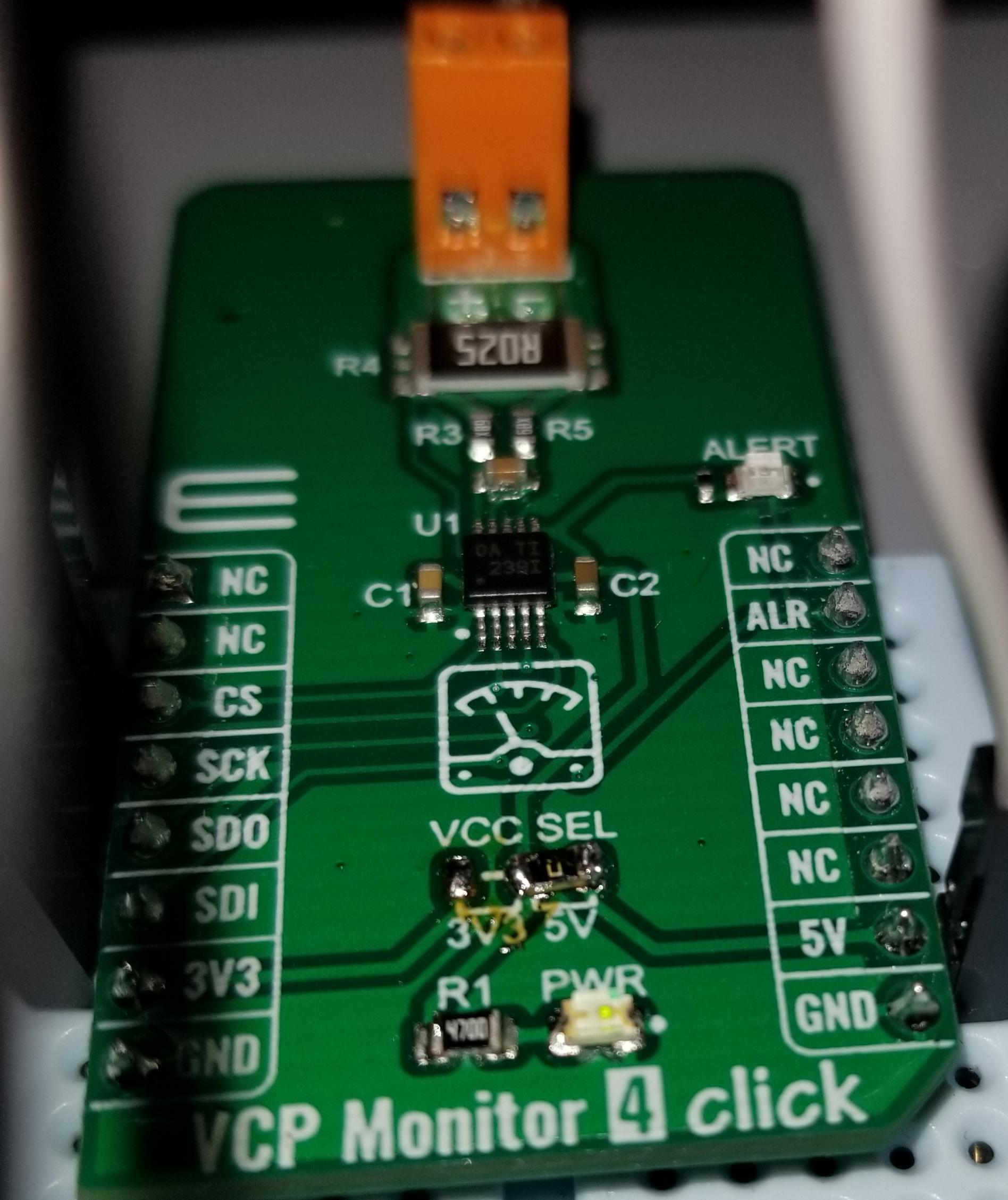

Here is the close up of the soldering. and the green light turns on with or w/out the GND connected back to the controller.
I would go around and touch up those joints, especially 5V and GND. You have several cold solder joints.
The jumper does not look good, as well. There is no need to keep it, as it is easier to solder a thin piece of wire across the gap, or just use a solder blob.
Inspect all connections with a magnifying glass for shorts, and use a brush with rubbing alcohol to clean off the rosin.

I think you should just consider it a damaged board and buy another.
Agree.
Given that the board was operated without a GND connection, some other I/O line had to substitute, which may have damaged the amplifier interface.
The soldering might be reparable but I would not trust the long term operation of that board.
