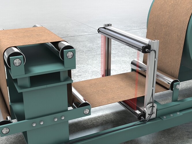

In short, I want to do something like this. I'm using 4 74hc165s that will follow the fabric and say the fabric is sliding left and right, it will write to the LCD which direction it is sliding. There are 32 inputs in total and each input has a receiver opposite an IR transmitter.
So ones increase the number, zeroes decrease the number.
This does not jibe with the first part.  Assuming eight bits, six up counts and two down counts results in four.  Explain.
I'm guessing you want a count of how many LEDs are blocked?
Then I would show the "width" and the "position".
For example the width is 30 leds and the position is -2 (because there are 10 on one side and 8 on the other side).
Yes...
I really thought I understood it when I saw the photo and you mentioned the sliding to the left and the right. So I thought you wanted to know the "width" of the fabric and "position" to check if it is in the middle.
But now it is counting the number of leds that are blocked, so I'm totally clueless again.
Counting binary 0 and 1 and checking for consecutive inputs for the fabric (there could be holes in the fabric), finding the position and all those things with a binary number is easy, but I can not put in code what I don't understand.
Start counting 0s from one end, if you hit a 1, save the number of 0s, then start a new count of 0s from the other end, stop when you hit a 1 and compare the 2 counts. If different by a certain amount, adjust position.
I think that I know what the miscommunication is, I was not talking in code but about a broader view what the project is about. I don't care about the actual implementation at this moment, so I don't care if inputs have to be counted to find the fabric.

Then I would like to see on a display how many centimeters the fabric is too much to the left or to the right.
that's right, i want to do this
that's right, I want to do this with mutual infrared receiver and transmitter, I want to track the position of the fabric between infrared receiver and transmitter

I want to track only position, not big or small size
That code looks like you're pretty much there - just need to grab the left and right edges as you read.
I couldn't figure out how to do this, I tried several methods. If I can get the incoming data between 0-254, I can achieve this, for example, if the value is 0, -10 shifted to the right, +10 shifted to the left.... because I need to save the incoming data to the eeprom, I will save the eeprom after the 0 point is determined, fabric It will give information on the LCD screen when it slides to the right or left from the 0 point.
