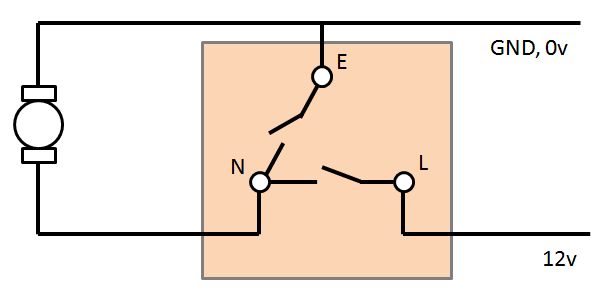

I have a DC motor (nominally 12v and 4A stall) control circuit that has to work within the confines of the electrical circuit shown in the diagram below. I only have access to what is inside the box so that the GND wire must go from power to motor directly, but I can get to it. The 12v supply is interrupted until I connect it.
I have successfully created a half bridge circuit which uses the mosfet between N and L to provide power to the motor using PWM for speed regulation and a mosfet between N and E for braking, again using PWM for regulation – making sure that neither switch is closed at the same time.
Unfortunately the braking force isn’t quite enough, even when “shorted”. I would have liked to have wired it as a full H bridge to put a little reverse (I know when the motor is turning and when its actually stopped) into the motor for a moment to assist.
Unfortunately it seems that the inability to break the GND line stops me from doing this... unless I have gone ‘circuit blind’ and there is a configuration!
If I could generate a negative voltage (doesn’t even have to be -12v) and could pulse that in at N that would probably do it but it’ll need up to 4A.
Any suggestions please as to improving the braking.

A full H-bridge can apply a reverse voltage. The motor would no longer be connected to GND, but to both half-bridges. The mosfets should be able to have some reverse current for 'normal' shortcut braking, in most cases that is no problem with mosfets.

No DPDT (or anything) unless it fits somewhere between N, E or L. Those three points are the only things I have access to - the rest of the circuit is a closed system.
Wondered about the effective shorting of the braking circuit. Difficult to manually short it out as braking is all over and done with in under 0.5 second.
I have selected the lowest RDS on mosfets I can... I have 23 different ones on test at the moment plus about 6 or more mosfet and motor controllers. Sure is being a difficult problem to solve.
Yes I have been playing with diodes and haven't given up with this approach yet BUT I think the mosfet is closing properly... however trying to find a way to establish how closed it really is.
Add a resistor of about 0.01 to 0.1 ohm and use a storage scope. That should reveal how much shortcut brake current there is.

I don't think the design you point out will work because the H bridge requires the motor connections to alternate between + and GND depending upon direction. As you can see from my constraint that one of the motor connections is always connected to GND.
I have had to do the motor control myself because the drivers I've tried unfortunately suffer from a hesitancy at during acceleration/braking cycles of about 3-4 times a second which cause the motor to stutter intermittently or they require four wires (like the H bridge design) which I don't have.
One product simply didn't provide any significant braking effect. Its taken me ages to get some individual mosfets to not suffer from hesitancy, failure to switch on fully or switch off or no braking... If I could do the maths that is needed to design it all properly I'm sure it would have been faster and cheaper but I've gotten a stable half bridge now but would really like to get more braking.
Please, if you can see a H bridge design that will fit into the 3 pin environment I have to work with, pop a schematic up I would much rather work with a conventional H bridge as it gives me much more and easier control over the braking side.
Then you would need +12V and -12V.
Is there a way to get to the grounded wire ? Drill or break something open ?
If you really can't break the ground wire, can you get a second 12v supply and connect + to GND and - to your controller? A second battery of about the same size as the original battery? Then you can drive the motor in reverse and get more 'braking' effect.
Your capacitor solution is creating a 'voltage doubler' configured to create a negative power supply. It could work but its efficiency will be low.
It seems a strange restriction when a normal H-bridge would do the job.

I am sure you are aware the braking by shorting the motor leads is limited by the resistance of the motor windings and brushes. Nothing you can do about that.
Can you introduce a separate 12 volt supply, completely isolated from ground and use that to stop the motor?

No can do.
I'd found something using a 555 that made +- voltages for small devices (op amps) but I need more amps.
MorganS:
Its slot car controller. If I put another battery into the system I'd be accused of cheating and I'd have to look for my testicles up my own arse... say no more

See my previous reply with respect to introducing another power supply.
All I 'see' are three holes as depicted by N, E and L and I have a three pin plug that goes into them. My world is on the outside of that three pin plug and that is where my mosfets, Arduino, LEDS, pots, triggers etc live.
