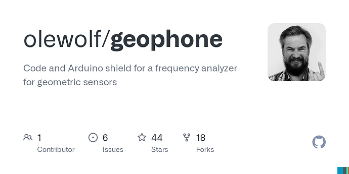

You will find more detailed instructions on an amplifier for this geophone here

here is the first part of the circuit. You can build it on breadboard.
Noise and signal are separated by a process called "filtering". The Ole Wolf circuit provides that filtering. You connect the geophone at JP1 and the output from pin 1 of the op amp connects to your ADC.
The TLV2462 will be suitable - but you need to build the circuit above - or similar - around it.
