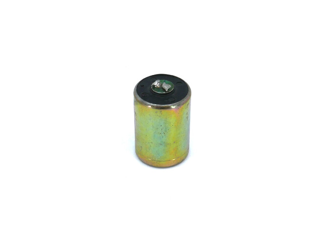

I'm trying to make a seismograph. I already tried using a wall brick, a transformer coil, and a magnet, with an LM358 amplifier and an Arduino Nano running the nerdaqII code. However, the results didn’t meet my expectations. The sensitivity is pretty bad—it doesn't detect footsteps, only jumps.

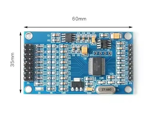

Now I'm planning to buy a 4.5 Hz geophone with 28.8 V/m/s sensitivity. I think I’ll use the ADS1256 ADC with the Arduino Nano to get 24-bit resolution, but I’m not sure which amplifier to use. I read in another post that op-amps like the TLV2462 are useful, but I’d prefer a ready-made module, like one with the INA333.

Your probably don't need 24-bits. Your "resolution" will be limited by noise. Analog electronics always have some electronics. Some amplifiers are noisier than others but a high-gain preamp amplifies noise along with the signal. Noise is almost always a challenge with low-level analog signals. :frowning:
More bits can give you more "headroom" (for major earthquakes, etc.) but I'd worry about noise first.
One thing that you have going for you is that it's possible to use a low-pass filter to filter-out everything except the low-frequency signal and low-frequency noise.
Also, most ADCs can't read the negative half of a sine wave so you'll need to bias the signal. The bias can be built-into the preamp and then subtracted-out in software. (Most Arduino "sound sensors" have biased output.)

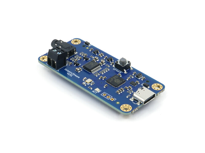

Check out the offerings from MindSets UK. They sell the same geophone used by RaspberryShake, as well as a 24 bit amplifier/ADC (with Rpi Pico 2) and some other accessories at very reasonable prices.

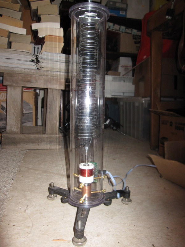

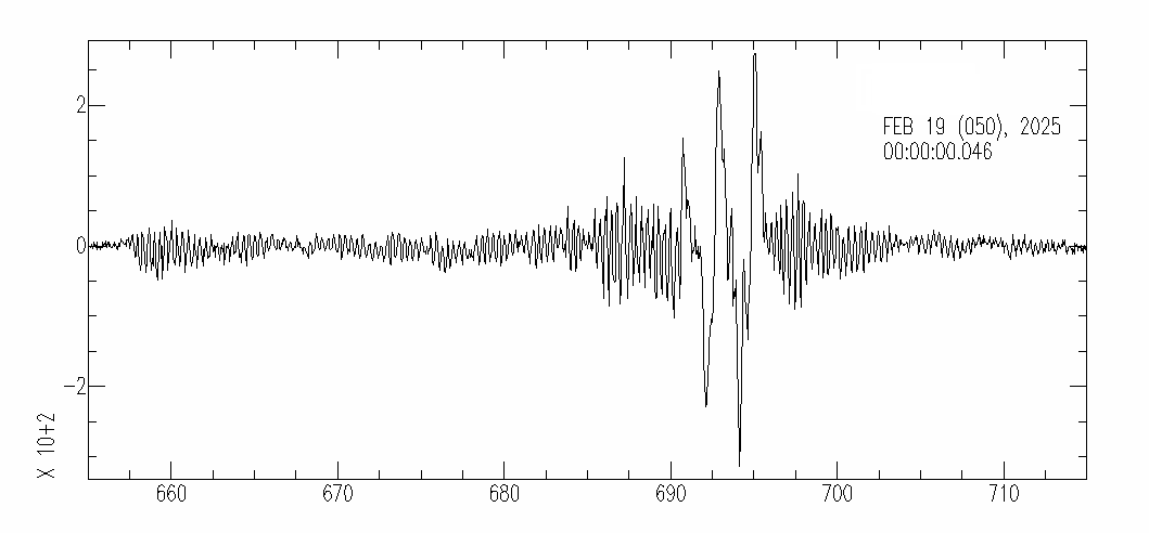

The TC-1 with nerdaq interface has the best performance of the DIY ones, and is sensitive enough to easily detect someone walking on the floor two rooms away, but it is several orders of magnitude less sensitive than the geophone + SeismicStream interface linked in post #4 above.
This is a P-wave recording from the TC-1 made of a magnitude 5.7 earthquake in Fakfak, Indonesia on Feb 18 2025 at 23:39 UTC. TC-1 is on the west coast of the USA.

I found a seller offering a geophone very similar to the one sold by Mindset — same frequency and resistance. I believe Mindset sources it from an AliExpress seller, since the same model is cheaper on AliExpress than on Mindset.

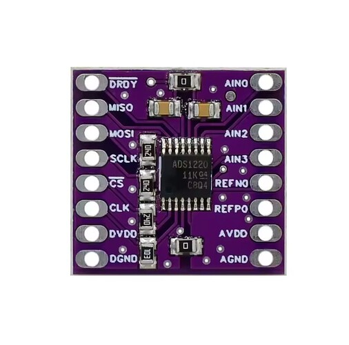

My only concern is about the amplifier and ADC. I’m considering the INA333 because of its low noise, and the ADS1220 as it also offers low noise with 24-bit resolution. My goal is to detect signals from 1 µm/s and above.
Here's the cheaper one I found: https://a.aliexpress.com/_mNBfXtZ
And here's the one I think I’ll buy: https://a.aliexpress.com/_mODfYUF

I made the TC-1 out of scrounged materials from the shop, a slinky, five neodymium magnets and a spool of #38 wire, more or less as described here.
Total cost was less than US$10.
BTW I rewrote the nerdaqII code, as it has a bizarre oscillatory response to an impulse that takes many seconds to damp down. Posted here, works much better.
Does anyone know how to connect the ads1256 or th
e ads1220 module?
Did it ever occur to you to do a web search? The first hit for "ads1220 module" is this
Already tried, maybe the crappy English I have is the problem, thank you!

After experimenting with the RaspberryShake-like setup, and examining some publicly available RaspberryShake data, I'm pretty disappointed with the performance.
I've concluded that for geographically quiet locations like mine, the rather expensive Shake is not an improvement over DIY TC-1 seismometers, as the higher bandwidth and resolution greatly increases the noise level (and reduces the SNR) for detection of the low frequency signals from distant earthquakes.
A writeup of my research, and much improved Arduino code for the TC-1 are posted on Github.
See below for comparison of seismograms from two DIY spectrometers (top) and a RaspberryShake station (bottom), all on the west coast of the U.S., of a magnitude 6.3 event in Ecuador on 4/25/2025 at 11:44:55 UTC, > 6000 km distant.
Click on the image to expand. See the problem?
As discussed on the Github page, it can be solved with additional filtering (post-processing), but then you are back to the response and sensitivity of the TC-1.
