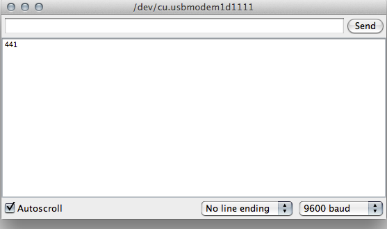

initial serial monitor test . puzzled by response
Following Simon Monk book "Programming Arduino", p. 39 . Here is my code
Serial.println(1234);
and the output to monitor is shown in the file. The monitor reports the most significant digit, then the number itself
When using the next program in his book with the following code
// sketch 03-04
int a = 2;
int b = 39;
int c = a + b;
Serial.println(c);
The serial monitor reports that seen in the second file. Again first we print the most significant digit, then the number.
I don't understand why.
Thanks,
Don

When using code
  Serial.print("Value =  ");
The results in Serial Monitor are shown below. It immediately prints V the after a moment Value
Could this be a workaround?
  Serial.print("");
...or a small delay after Serial.begin(9600) or test with another baudrate.
They're at 1.05 r2. The last revision for 1.56 r2 was "JSSC: Fixed NPE when RXCHAR event with no bytes (José Pereda)" Not sure if something similar was done in 1.05 r2 or even if this was the issue ... but there is a newer revision available.
I just re-downloaded ver. 1.05 and the behavior is unchanged. The code
  Serial.println(3234);
Still produce output 33234 in the serial monitor. Immediately you get 3 followed later by 3234.

I understand it works for everybody else. Here is some further tests by adding lines
  Serial.println(5678);
  Serial.println("hello world");
Gives the first Serial output.
If I change the code to print a blank line so that it looks like
  Serial.println();
then I get the next result. It's a workaround, but it should not be necessary. Why is my iMac (10.9.2) doing this?

It is set to Uno. I was using a powered usb hub to power the uno. Have just added a 9v battery for power, but results are the same. Also connected directly to usb connector on iMac with unchanged results. Always get an extra character unless I insert that print blank line statement.
Does the problem still happen if you use a terminal emulator on the Mac instead of the Serial monitor in the IDE ?
