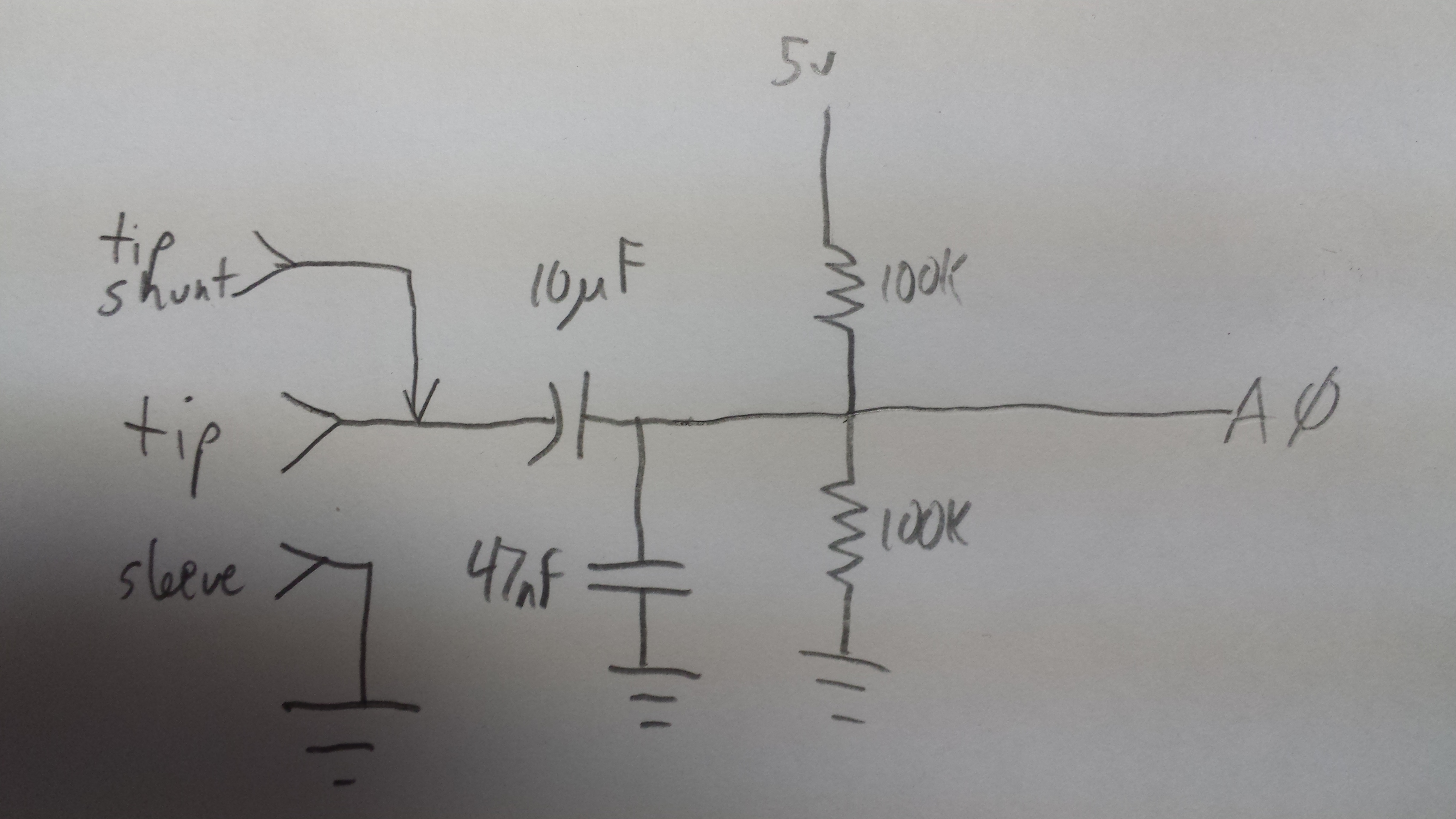

Thanks for the quick reply. This is what my intended circuit looks like:

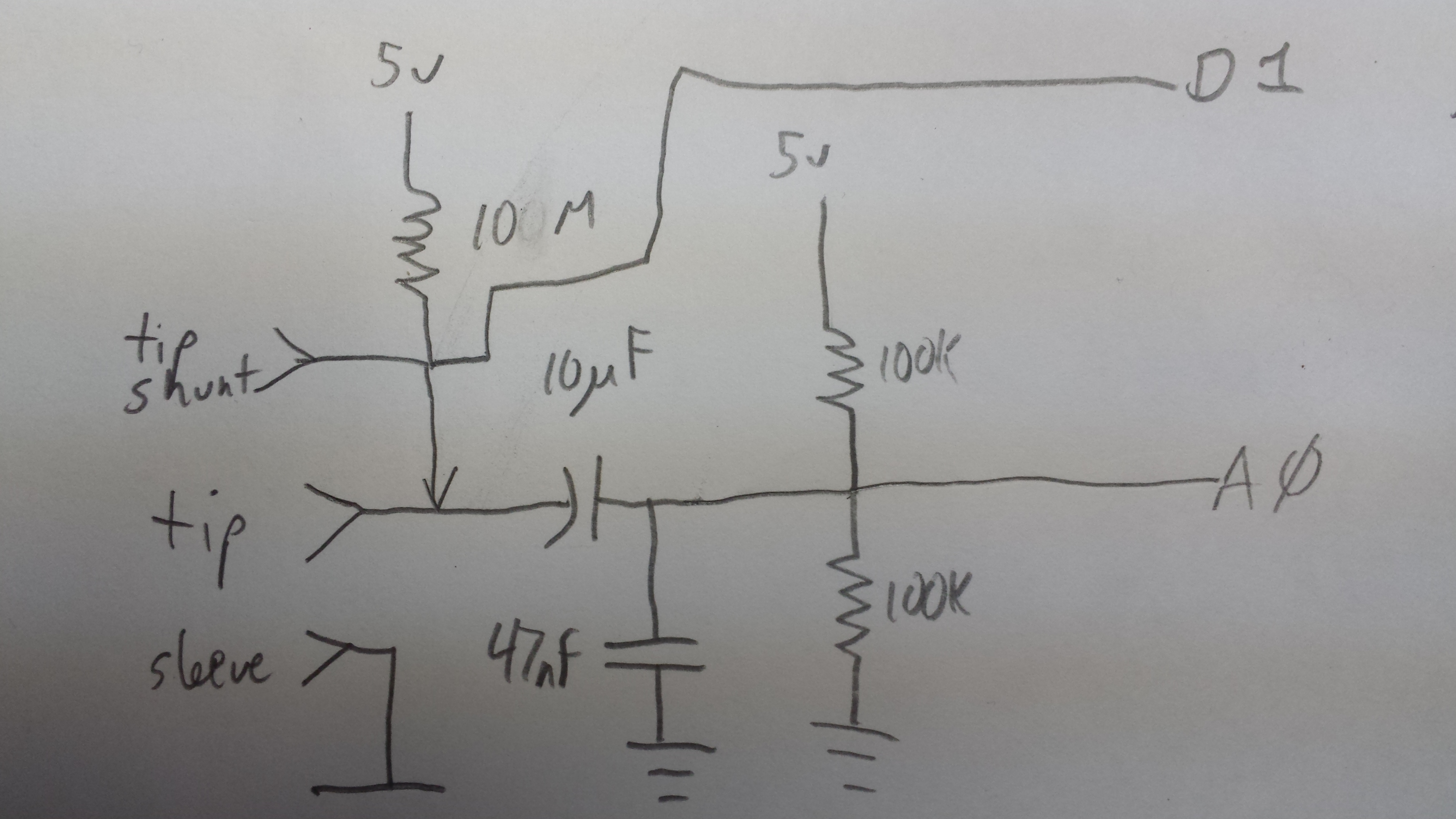

If I understand you correctly, I'd put the pull up resistor on the switched pin of the jack as follow:
Instead of the pull up resistor, could I use the internal pull up capability of the Arduino for its digital inputs? Also, I do not understand your comment regarding the large resistance would reduce chance of noise, if the pull up resistance is connected to the switched pin, it would be disconnected up insertion of a plug in the jack thus no longer in path of audio current, wouldn't it?
Thanks for the assistance,
Dan
No, that won't work as you don't have a DC path from the pin to ground. Perhaps add 100k to ground on
the signal pin to ground - it'll beat the 10M and doesn't present too large a load.
