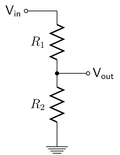

edit: I'm thinking that maybe one of the side of the sensor is ground (when I measured -0.007v), and on the other there's a resistor on the positive pole. So, with the second resistor along the wire of the sensor, the result is a voltage divider, and this could explain my measurements.
Vin: ≈13.50V
R1: ≈800 ohm (hypothesis)
R2: 6800 ohm (I know it's on the sensor wire)
Vout: ≈12.10V
Wrong because Vout will be positive.
Vout is positive, it's alway 13.52V or 12.10V, the other side of the sensor is negative, but just a few of mV, so I thought it could be the ground.
