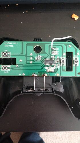

I've searched but I could not find a direct answer to what I'm trying to do. Like the title says I am trying to wire an Arduino to the four buttons on the remote(attached pic) that control movement of the RC car. From what I gathered I need to use relays, but I am confused on how I am suppose to wire them to the remote and then to the Arduino. I have some 5v relays, but from what I read they might not work due to the remote not having enough current to "energize" the coils in the relays, so I may need reed relays. Any help would be most appreciated.
The relay contacts must be connected in parallel to the switches, so that they can bridge the switch contacts.
Note that the RC batteries must supply both the Arduino and the relay coils.
