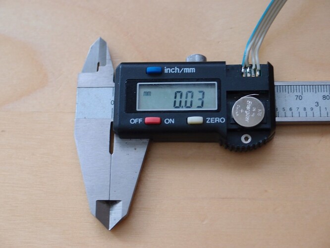

For those who are interested in interfacing Arduino with a cheap digital caliper I have placed a short project description under
Great work, thanks for sharing.
What does the output looks like?
value in which units?
The output which appears on the serial monitor is exactly the same as you read on the caliper's LCD. It is the caliper's measurement in mm, with 2 decimals, e.g. 4.52
The code provided works only with the caliper set in mm mode. With the caliper in inch mode the code needs to be slightly modified.
regards
If you switch mode can that be seen on the interface?
In the case of my caliper none of the 24 data bits codifies for inch or mm mode, so I guess there is no possibility of automatic detection of the mode.

this is exactly what I am looking for, tried it, doesn't do anything for me, no serial output at all.
I am using bc550c transistors.
I have no clue what is wrong.
@heng1
what calliper are you using?
picture?

Hi, I am trying to create a digital readout display for my boxford lathe using two calipers one on the bed and one on the cross slide.
I have copied your text and my caliper interfaces perfectly thanks for the great coding I have tried to add a second pair of calipers but have failed miserably could you suggest how it could be done so that caliper one displays on line one and caliper 2 displays on line 2. I have managed to make line one of my 16x2 lcd read as follows. Bed 0.55 mm being bed as description 0.55 being the caliper measurement and mm obviously millimeter's and line 2 show C/slide 0.55 mm but I can't add to the coding to read from the second caliper I have defined data and clock pins for caliper 1 and caliper 2 and defined them as inputs but I can't get the read command to work for caliper number 2 can you please help/
thanks for the great code and in anticipation
I am getting some noise on the lines. Somone had posted a link to change the code to include the units i.e. mm or inch in bit 24.
My Harbor Freight calipers seems to have noise that mixes up bit 24 when the reading is changed. Anyone have noise issues?
