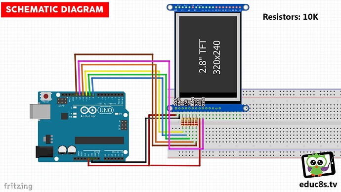

Hi, newbie here. so i want to ask,
  1. So the ILI9341 is 3.3v and arduino 5v. In the schematic, why he connect the vcc to the 5v? shouldn't he connect to 3.3v instead?
  2. what if i connect the vcc to 3.3v, then proceed to connect other pins without the resistor
Please post a link to its datasheet.
https://www.digikey.com/htmldatasheets/production/1640716/0/0/1/ili9341-datasheet.html
this is the link
It says:
LCD Voltage drive:
 Source/VCOM power supply voltage
 AVDD - GND = 4.5V ~ 5.5V
 VCL - GND = -2.0V ~ -3.0V
im sorry, but im not quite understand. meaning that the lcd must be connect to 5v in arduino?
Yes, but to that pin, AVDD. The LCD obviously need 5 V. The logic signals are 3.3 volt. It should not be directly connected to 5 V controllers like UNO etc. Level shifting is needed.
so, the lcd power is 5V. however the only the pin voltage is 3.3v. using this logic level converter is sufficient right? just connect the arduino 5v directly to the lcd vc, and the other pin to this shifter
Looks good.
