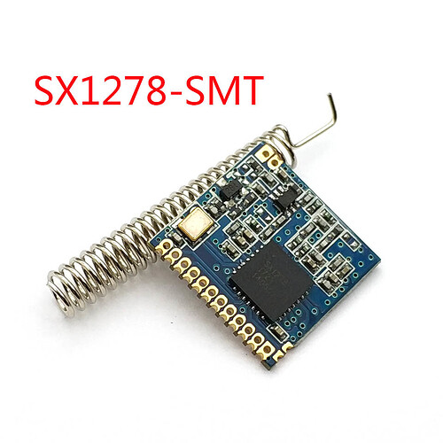

Yes Dear, it is the same device, but now I'm going to replace it with:
LoRa Long-Distance 433MHz Communication SX1278 with Antenna
wishing that it works.
can you give a web page link to the device? there are many Lora boards which fit that description
SX1278 based Lora device interface protocol SPI - if you do a web search for arduino SX1278 you will get plenty of links
so you think that it will work correctly Sir?
you could connect your Lora module to the SPI bus of your MEGA and use one of the Lora SPI library to drive it
